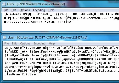

How do find out the version of isodraw files ?
    May 24, 2011 1:04 PM UTC
    Open the file in a text editor and go to the end of the file. There will be a "signature". See some examples in the attachment.
    Not sure it's 100%, but it works.
