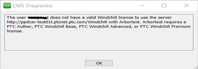

Getting below error “The user xxx does not have a valid Windchill license to use the server http://abc.com/Windchill with Arbortext. Arbortext requires a PTC Author, PTC Windchill Base, PTC Windchill Advanced, or PTC Windchill Premium license.” when connecting from Arbortext Editor(client) to Windchill Server despite that user has the VALID license?

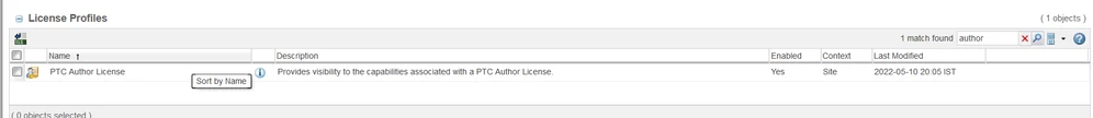

Step 1: Add that xxx user under any of the above profile mentioned in the snapshot/CMS Diagnostic dialog in Windchill > Site > Profiles > License Profiles and search for these license profile. Below is just an example for adding the user under ‘PTC Author License profile’

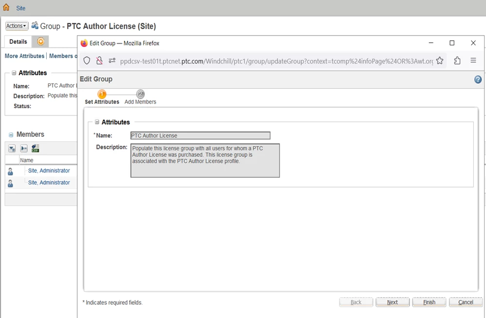

Step 2: Click on ‘i’ button and then edit the group
Step 3: Click Next and then click ‘+’ for adding that member/user
