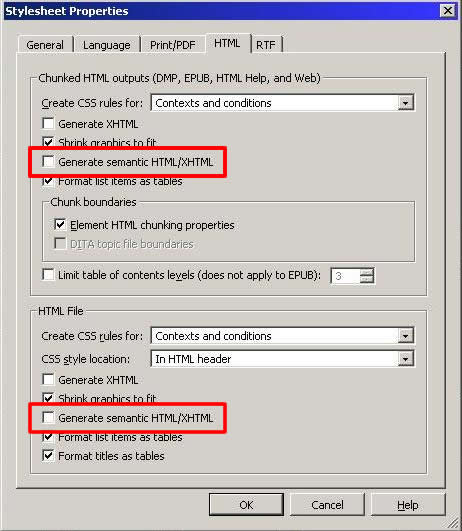

  • In the HTML tab, there is a new option to 'Generate semantic HTML/XHTML'.
    This option will tell Styler to generate <p> and <h1> type HTML tags rather than the <div> and <span> tags it was generating before. As I mention above, this gives the assistive technologies a better idea of the meaning of the content.

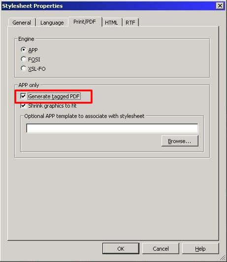

  • In the PDF tab, if you have APP selected as your output engine, there is a new 'Generate Tagged PDF' option.
    This option will tell APP to generate a tagged PDF.

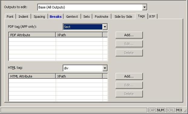

With both HTML and PDF tagging, a set of default tags will be applied based on the style applied to the element in Styler. But what if you want to change it? Styler has a new 'Tags' tab which allows you to set the HTML and PDF tag you wish to generate for each element, context or even condition.

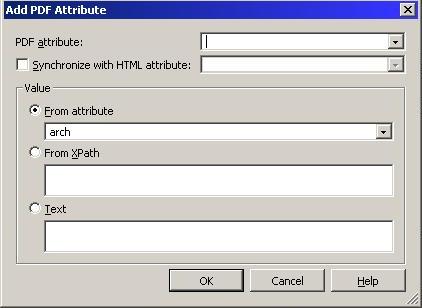

The Tags tab allows you to set the PDF and HTML tags. The list of tags available is derived from what makes sense for the styled element in Styler (so you can't tell a list item to be the document root). Also on this tab is the ability to set attribute values on the tags being generated.
This is where you would set the 'Alternate text' for graphical components, for example. Attribute values can be generated from an attribute value in your XML, from an XPath expression or you can key the value in yourself. To save time, the PDF attribute can be told to match that you apply in HTML.
