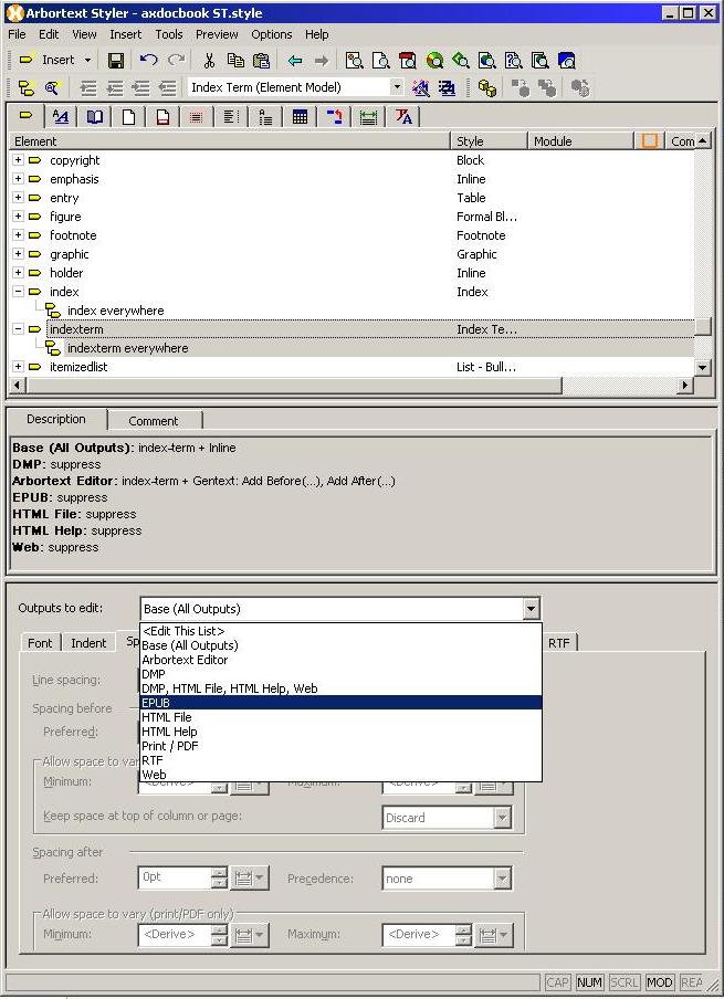

Inside Styler, you will see that EPUB is listed in the 'Outputs to Edit' drop down menu. This means that you can create specific styling for your EPUB output which overrides the base output's styling. As each EPUB reader interprets EPUB slightly differently, this will be useful to fine-tune your output for your target devices and platforms.

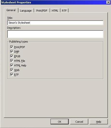

You will also need to make sure EPUB is selected as a Publishing Type in your stylesheet properties.

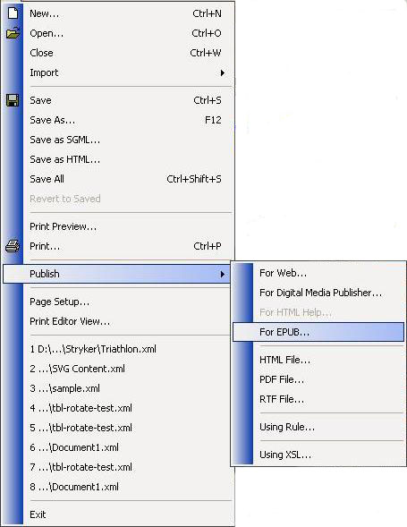

When you've created your stylesheet, you can preview (which will display the EPUB output using Calibre) or you can Publish. EPUB is provided as an output to publish to in Editor's Publish menu.
