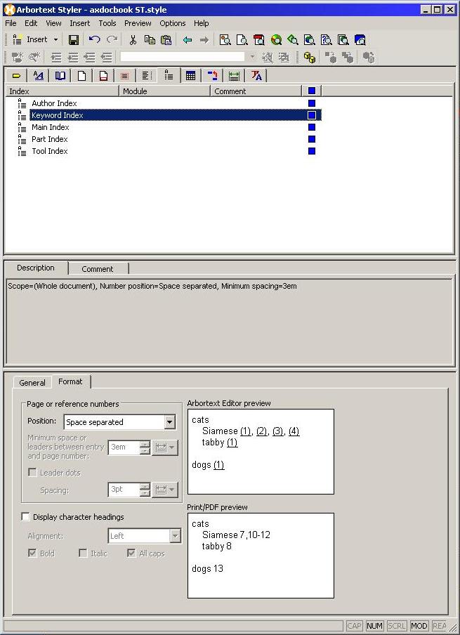

Index definitions have been moved out of Styler’s menu system and into a new Index definitions tab. All the properties and settings you are used to now appear as properties and settings of new named index definitions which you can create as part of your stylesheet. As with other definitions in Styler, you give your index definition a name by which you can refer to it when you want to use or target it.

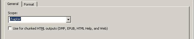

A new feature of these index definitions is that now an index can be scoped. This means you can create a separate index for each chapter in your book, each article in your multi-part publication or even each section in your manual. That index can be used to list the tools or parts used per procedure, for example. By default, the whole document is the scope. This option is on the General tab.
