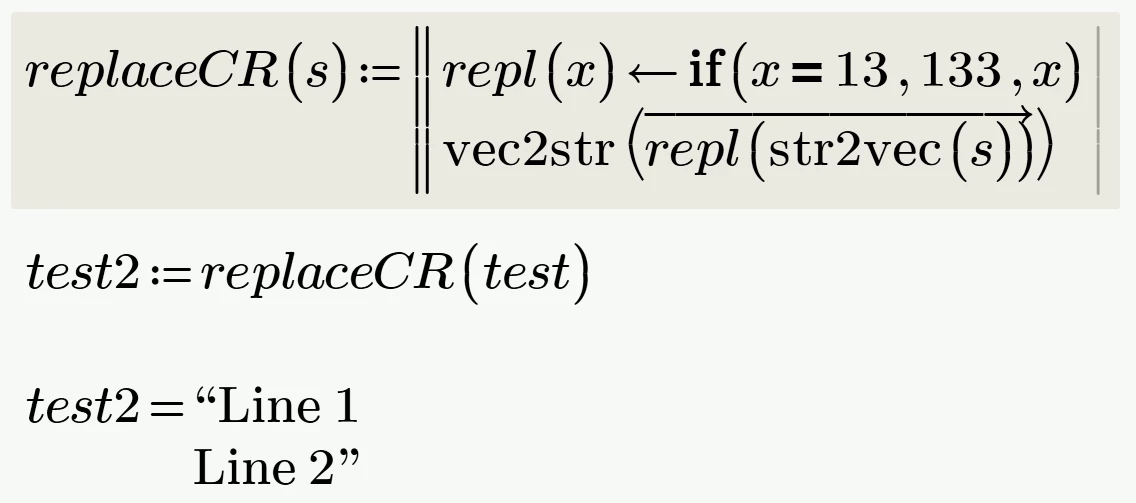

OK, I didn’t want to wait so i created the few line myself.
Here is a small utility function which replaces all carriage return characters (#13) in all strings contained in a Prime matrix by the character #133. Non-string valued remain untouched.
The resulted matrix can be used for display (it shows the desired line breaks) but can’t be edited (at least it can’t be copied).
That way even Prime 11 can show a matrix like
The attached archive contains the demo Excel sheet along with the Prime sheet, which also shows how the embedded Excel sheet could look like.
Maybe ​@amcgough  can comment if the change in display of strings in Prime 11 was done intentionally or if it was a side effect of another change. And of course it would be of interest if it is planned to restore the initial way so a CR creates a multiline string in Prime again.

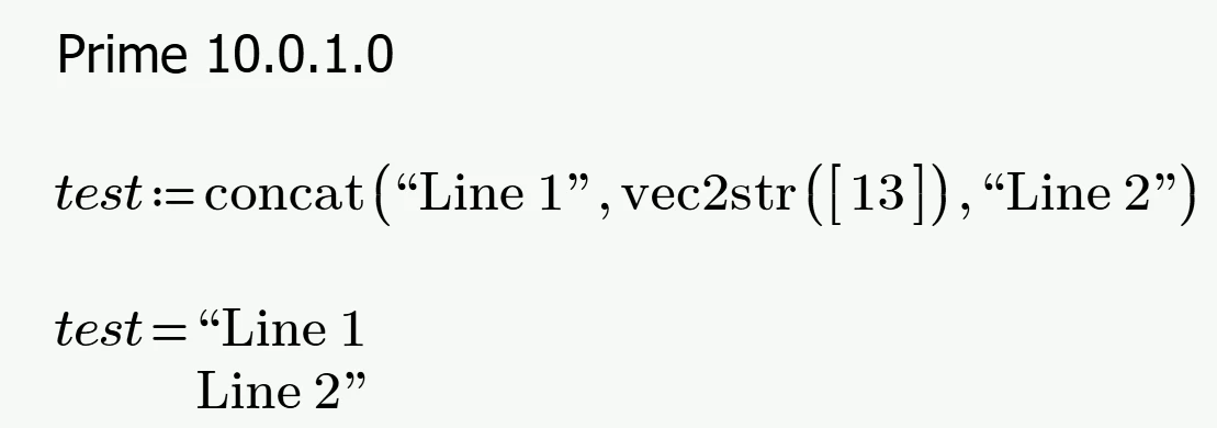

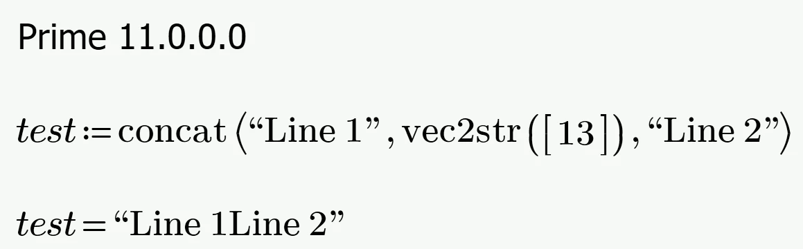

I can't be entirely sure, but it might have something to do with the change in Prime 11 regarding how carriage return characters (#13) are displayed in Prime strings:
The workaround with replacing the CR with #133 may have some undesired side effects when it comes to editing (especially the strange effect when you try to copy and paste the “test2 = ...” region)
(Sorry for the huge pics - I see no way to scale them after inserting them)

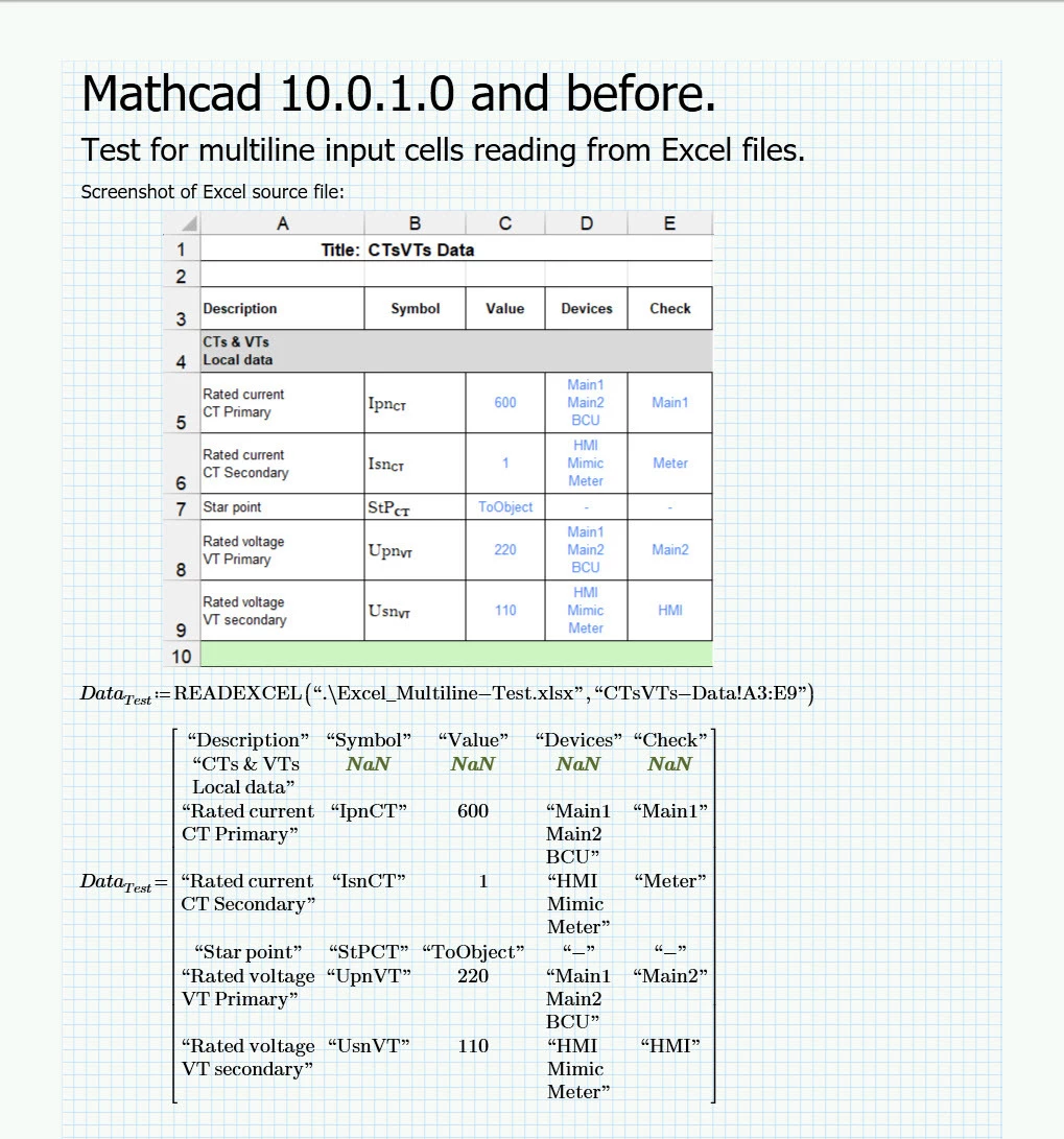

Thanks to both, however it is not related to text handling inside Mathcad, it is purely to maintain the multiple line formatting of the text read from Excel when displaying it in Mathcad, here the examples.
Mathcad Prime 10.0.1 and before:

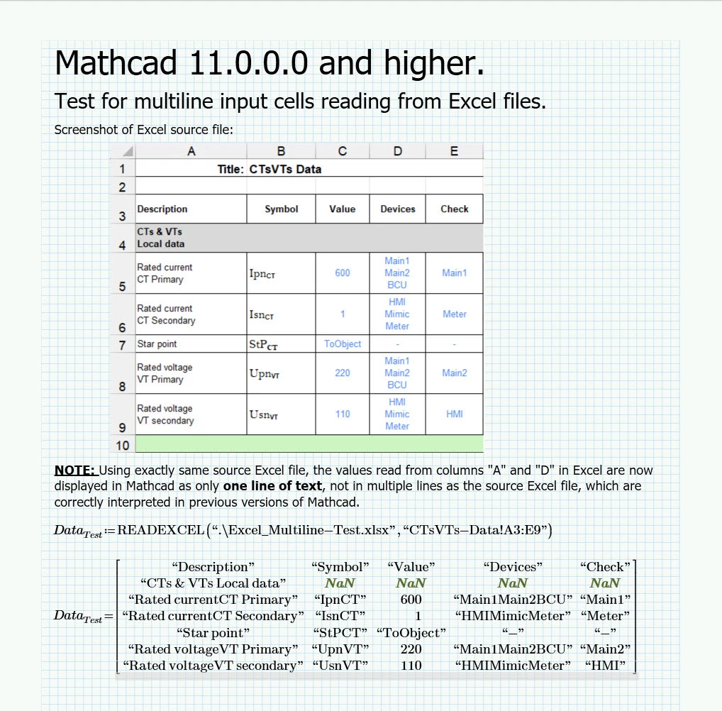

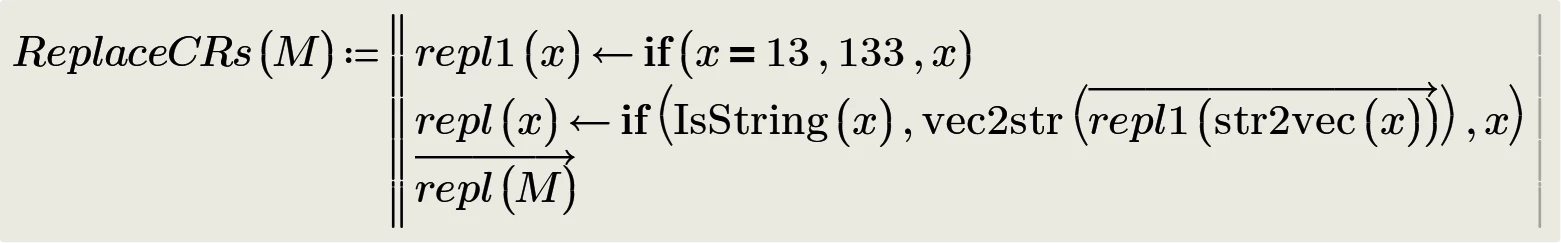

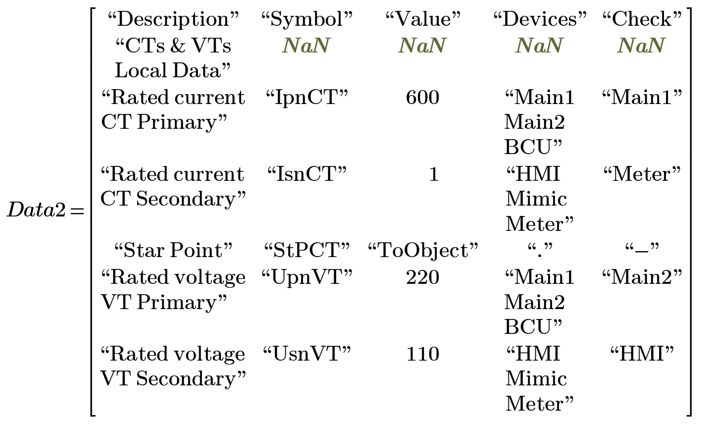

Mathcad Prime 11.0.0 and higher:
Excel_Multiline-Test_11.0.0.0
Multiple line formatting is totally lost, therefore, for bigger tables with multiple lines in Excel, it is impossible to present the values in Mathcad, as whole text is in a single line and table became so wide that doesn’t fit within the page.

From what I see the problem actually IS the change in Prime 11 how text strings containing a CR (#13) are displayed.
When you read from Excel I guess the strings in your Prime matrix correctly contain carriage returns but Prime does not display these string in multilines but rather seems to ignore the CR.
You may set up a demo Prime 11 sheet along with a demo Excel sheet and I may be able to provide you with a function which replaces all CR’s by character #133 in all strings of the matrix you read in. If its just for display purpose the aforementioned side effects possibly won’t matter.  I know it's still not your desired behavior of Prime, but it might be a viable workaround.
