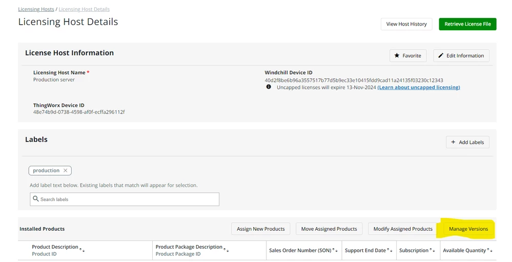

How can an admin create licenses for older versions of the products?
Any help on this one?
    Jun 4, 2024 3:30 PM UTC
    On the Licensing Host Details page, there is a button above Installed Products called "Manage Versions":
    Clicking that button allows you to change the version for any of the product groups included on the host:
