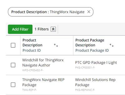

ThingWorx vs Windchill?
When trying to add some licenses to a Windchill server, I'm getting a required field to add a ThingWorx Device ID? Why is this being required?
    TomU
    Jun 4, 2024 3:04 PM UTC
    You must have selected one or most ThingWorx licenses in your allocation.  Deselect those and it won't prompt for a ThingWorx Device ID.
    Jun 4, 2024 3:11 PM UTC
    @joe_morton , @TomU There is one product in particular that is used across Windchill and ThingWorx bundles. It is ThingWorx Navigate. Since you are intending for a Windchill Instance, you need to ensure you are selecting the Windchill version which is noted in the Product Description and can be identified by the Product ID starting with 'W' instead of 'T' - if you select the ThingWorx Product ID, the system will prompt for the relevant device ID.
    Jun 4, 2024 3:15 PM UTC
    Here's a side by side as an example:
