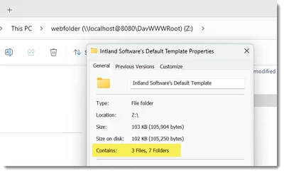

Perhaps one more idea that does not involve downloading the folders & files but uses the same concept: you could map the Documents using WebDAV. Once Codebeamer Documents are mapped as a network drive, you could just analyze the properties of the folder having the name of the project:

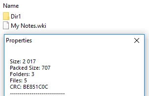

I don't think there's an easy way to do this. What you could do, though it’s kind of a hassle, is select everything in the root and hit the download button.
That’ll create a zip file with all the stuff in the Documents section. Then you can use something like 7zip to see how many files and folders are in it without unzipping. Or you can unzip it and check on your computer.

Thank you for your help! I tried @alfonso_c solution instead as there were way too many documents to download.

Thank you so much for your help! This solution works !
