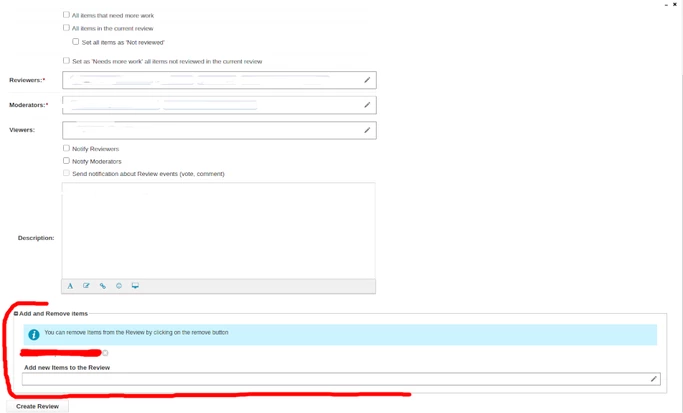

I wonder if it is possible to add and remove items to a merge request (when restarting the merge request). This feature is available on regular reviews, however the option isn't available when restaring a merge request review.
Our workaround has been to use regular reviews on the working set itself, before doing a "bogus" merge request review that points to the original review in order to be able to include and remove items according to the feedback from the reviewers. This however is far from ideal as the merged item doesn't has a direct link to the original review done with all the members.
Feature available when doing a regular review hub restart:

Unfortunately in current Codebeamer this is not possible.
Please create a feature request for it here:
https://community.ptc.com/t5/Codebeamer-Ideas/idb-p/codebeamerideas
in order to Product owners be aware of this request and can prioritize and plan into a future release of Codebeamer.
Up until the feature implemented, use the workaround, you described.
