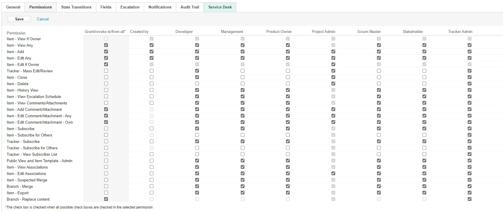

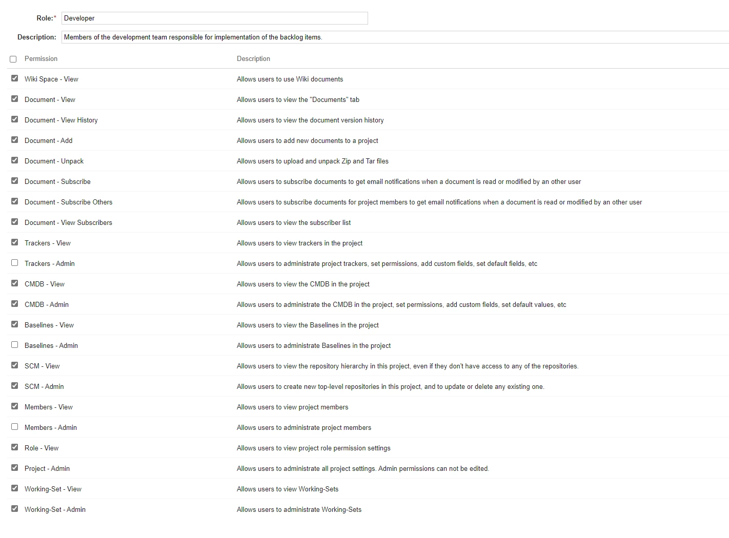

Hello all,
test case can be created only if user is member of Project Admin role.
There are 6 roles in total and none of them do not allow to create test case.
User has developer role and even all permissions are checked then creation is still not possible.
Do you have any idea what else need to be set?
Attached Test Case permission matrix and developer role matrix.
thank you
Sep 23, 2024 1:41 PM UTC
Hello Catalina,
found the workaround.
Create a new role for project based on Project Admin role.
Then adapted role rights as same like user original role has.
Sure there is also set right for each tracker, wiki, etc.... to be aligned with original user role.
If you create new role based on existing user role then creating test cases not work.
For some reason only based on Project Admin role works.
Strange is that current role worked before...
