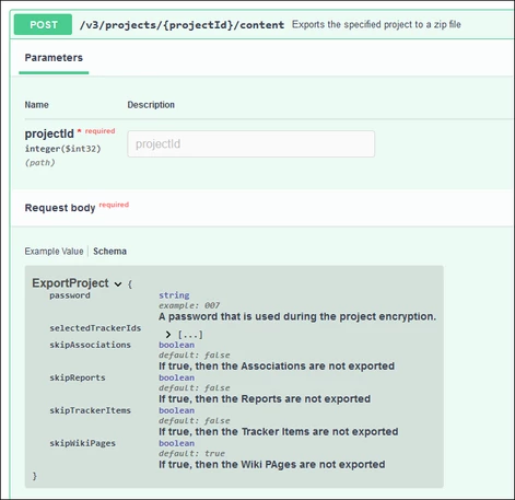

Can we do "Export project as Template" using API ?
Can we do "Export project as Template" using API?
alfonso_cAnswer
Oct 8, 2024 6:35 AM UTC
Hello @SJ_7748282 , yes, this is possible, you can use the POST /v3/projects/{projectId}/content endpoint:
Note that I tested on 2.2.0.0.

Thank you for taking the time to help me out. Your solution was exactly what I needed!
