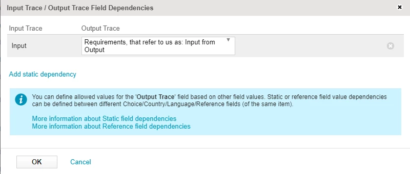

First, I used Reference dependency for the Output Trace of Result tracker.

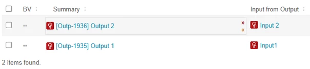

Since Output has an upstream reference to Input, you can set the proper relations in the Output items, and you can use this as dependency on the Result tracker:
The upstream reference from Output to Input is "Input from Output" in my case.
So these are the rules:

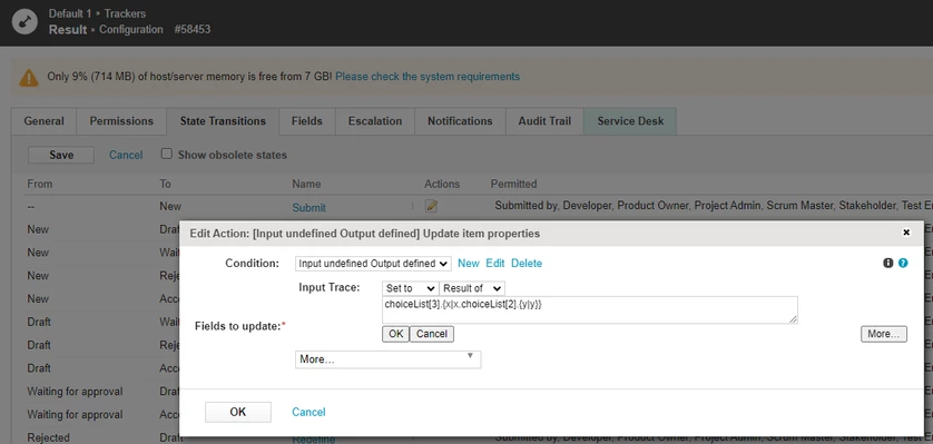

If you create it as downstream reference from an Output item, then you will need a workflow action to set the Input Trace automatically.
This is activated on the Submit state transition, choiceList[3] is the Output Trace field on Result tracker, choiceList[2] is the Input from Output field on the Output tracker.

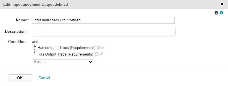

The condition makes sure that this update will be executed only if Output Trace is given, and Input trace is empty:

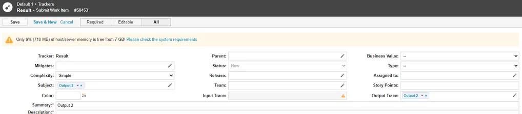

When creating the downstream reference (with R+) the Input Trace will be empty and read-only first.

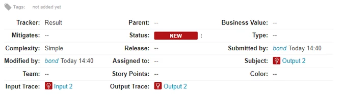

If you save the new item, Input Trace will be filled automatically.
