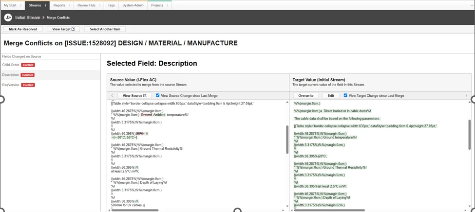

Merge is performed automatically, and after only, alerts you when conflicts occur. There is no discrepancy report before the merge takes place.
Lack of ergonomic to evaluate the differences. Merge Conflicts tool isn't very convenient for viewing differences.
