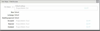

CodeBeamer: Adjustment of test step field permissions not possible
We're currently struggling with a test case tracker configuration in CodeBeamer 22.04-SP7, where we cannot seem to change the permissions of the test step table field (see screenshot, no adjustments possible, controls greyed out/deactivated)
bee67e57-ac9f-4596-a15f-dc850ee7b66f.jpg.
As a result, only project admins may read/write the correpsonding field but no regular users. As we want to avoid giving all users admin priviliges, is there maybe a way to get this working? Other fields of the same tracker may be modified as usual - this only applies to the test step field.

Thanks for the reply, we found an alternative solution that didn't require modifying configuration files. It seems that we've had a change in our users that might have led to this issue to occur in the first place. Nevertheless, creating a tracker from scratch has resolved it for us and we're able to change permissions now.

Dear @TD_10768648 ,
I believe the following article will answer the above question: https://www.ptc.com/en/support/article/CS414756
Let me know if you need additional support.
Gabor
