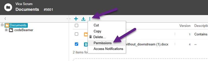

Does codebeamer can be configured with OOTB functionality to allow only project manager to have download access to the documents and restrict to others project members.? Project members are subjected to make changes in document.

Open the Permissions page of the document:

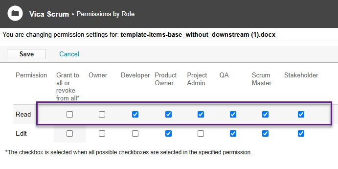

and remove the Read permission from the member's role:

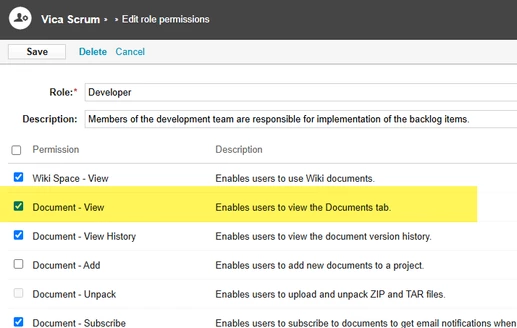

Or you can do it for every document in the project with the change of the role permission:

Hi @GC_11553948,
In codebeamer if a user has read permission for a document, then he/she has also permission to download it.
You can only hide the document from them if you don't want to allow downloading.
