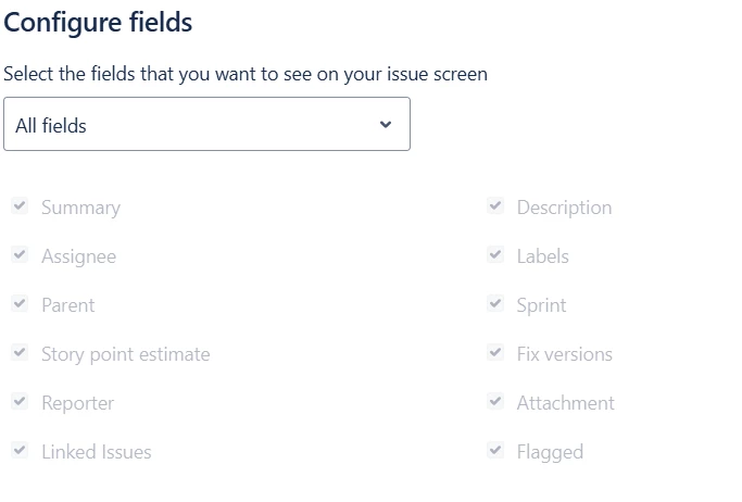

I have synchronized Jira with Codebeamer and have mapped some relevant from Jira to Codebeamer. But I am facing issue with two fields, Assignee and Reporter field. While mapping I can't see the option to map  Assignee field of Jira to Assigned to  field of Codebeamer.

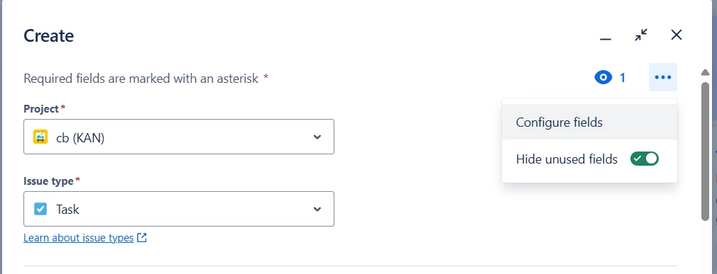

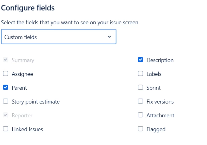

Hi @AarushiS ,
Could you check if you have the corresponding custom fields active in your Jira project, when you create a new Jira issue?

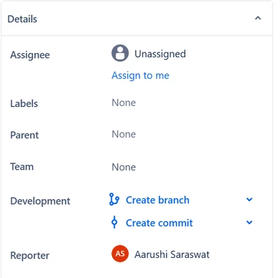

AarushiS12-AmethystAuthor
Mar 12, 2025 8:36 AM UTC
Hi @cristina.b, I just created an Issue in Jira of Task type and could see Assignee field has 'Unassigned' value and Reporter field has 'Aarushi Saraswat' as me who as reported the issue.

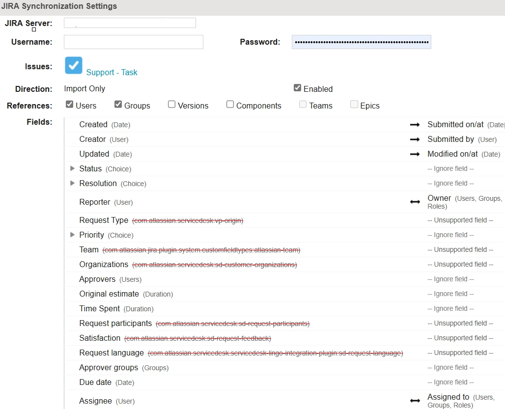

Mar 12, 2025 12:31 PM UTC
In the tracker's Jira synchronization settings, are the Users and Groups options selected?
