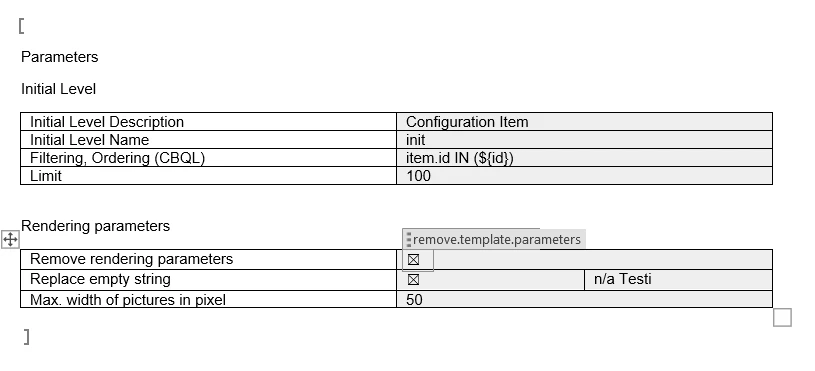

In my Word export template, I want to remove the tables inside the “template_parameters” bookmark during the export from Codebeamer.
However it seems I cannot get the syntax right. For other content controls it works just fine.
There are two issues I currently have:
  1. The “removal of the rendering parameters” does not work.
  2. The max. image width/height during export of the mergefield for “item.description” does not work.
I have been testing different syntaxes but could not make it.
Unfortunately, I cannot access the Word template documents linked on the Wiki like this one:
Rendering Parameters
Would it be possible to post the relevant .docx templates here and/or give me the correct syntax?
Thanks!
