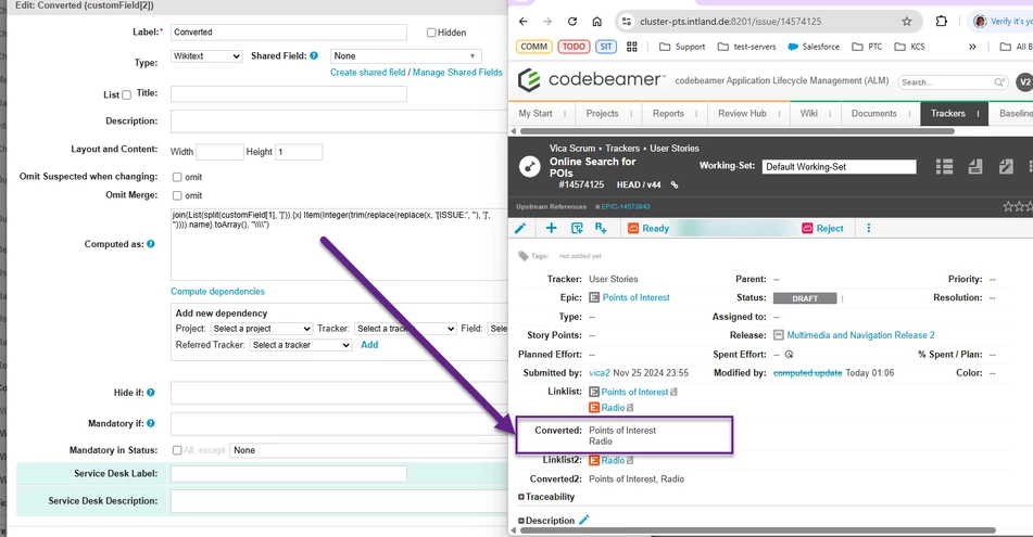

Mar 12, 2025 12:13 PM UTC
Hi @vjub58 ,
I've built the formula. I'm not sure it will work in all cases, so it might need tailoring later.
join(List(split(customField[1], ']')).{x| Item(Integer(trim(replace(replace(x, '[ISSUE:', ''), ']', '')))).name}.toArray(), "\\\\")
where customField[1] is the wikifield containing the links.

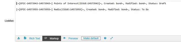

Is this how the wikitext look like?:
In edit mode with markup:
