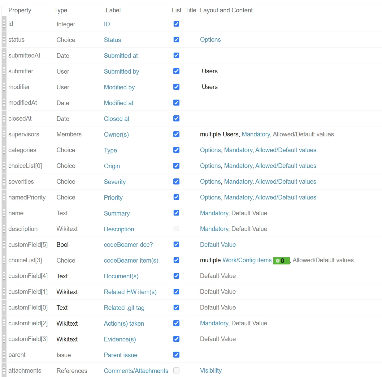

I'm trying to customize an Excel template to export the different fields of my Issue tracker (see issue_tracker_fields.png for the fields).
The "basic" template from codeBeamer does what I would like to do for the exported data but I would like to customize its style, for both single and multi row options (enabled through the GUI).

Note that the multi choice fields are only: "Owner(s) and "codeBeamer item(s)"
Could you please help me to correct my template to achieve similar results?

I found https://codebeamer.com/cb/wiki/1563473 which talks about getting each comment listed as its own line by using an additional forEach loop. With that information I started from your template and updated the "Owner(s)" column to have:
<jt:if test="${item.supervisors != null}"><jt:forEach items="${item.supervisors}" var="supervisor">${supervisor.name}</jt:forEach></jt:if>
And the "codeBeamer Item(s)" column to have:
<jt:if test="${fields.getByLabel(item,'codeBeamer item(s)') != null}"><jt:forEach items="${fields.getByLabel(item,'codeBeamer item(s)')}" var="cb">${cb.name}</jt:forEach></jt:if>
That gave me an export looking like:
