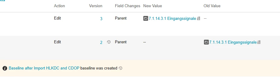

Attached you see the history of an affected work item. After the initial import I had created the baseline and then although I imported the same file twice, once the parent work item was removed and with the second import it was restored.

Hello @ME_12824198 ,
This is a known issue, and has been fixed in these versions of Codebeamer:
  • Corrected in Codebeamer 22.10-SP10
  • Corrected in Codebeamer 2.0.0.4
  • Corrected in Codebeamer 2.1.0.2
  • Corrected in Codebeamer 2.2
