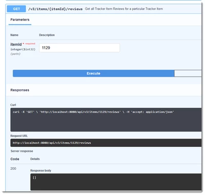

GET /v3/items/{itemId}/reviews End point is broken
Does anyone have any other alternatives or suggestions
Is PTC planned to fix this in future versions?

On the support ticket logged after this conversation, we clarified that the GET /v3/items/{itemId}/reviews endpoint returns empty response because the itemId has a Review Hub-based review, and not an Item-based review. These look similar but have a different header on the UI.

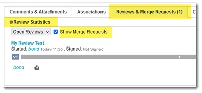

Review Hub (NOT supported by the endpoint):

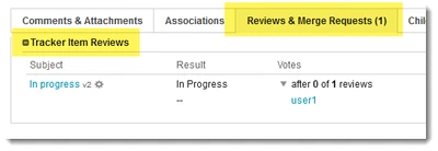

Item-based Review (supported by the endpoint):

I tested on 2.1.0.1 and the endpoint is functional for me:
