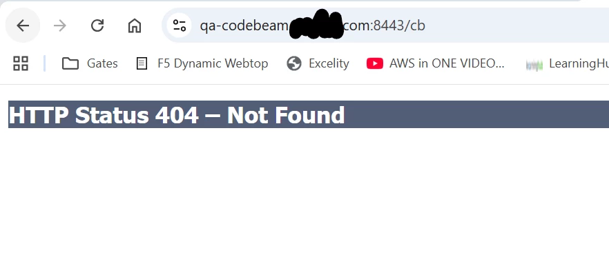

Getting this error on CodeBeamer url : HTTP Status 404 – Not Found
Hi All,
We have installed codebeamer(2.2.0.1) on linux server. Recently the IT team migrated the server from hyperV to Openshift. Since then our codebeamer url is giving this issue "HTTP Status 404 – Not Found". In logs we dont see any relevant issue other than below mentioned (kindly help if someone has any idea of what might be the root cause or solution) : (i have changed to port and ip by adding XX, please ignore that)

Hello Sumit,
You may need to check yaml and following details:
value: 'true'
- name: CB_FLEX_LM_LICENSE_SERVER_LINES
value: SERVER <HOST> <MAC> <PORT>
And then this host mentioned is accessible in openshift.
is this host also moved?
is MAC changed for this host?
if any change happened, did we apply it in the license file as well in flexLM.
These could be generic investigation points for FlexLM error.
