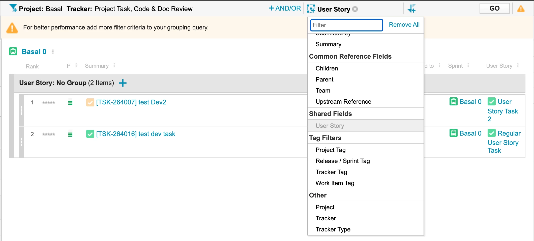

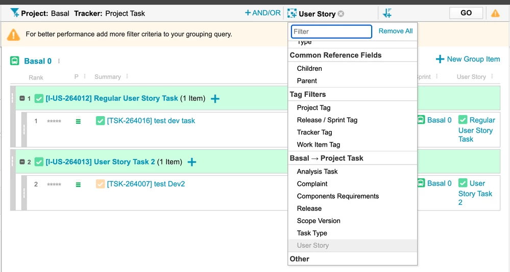

Is there a way in codebeamer 2.0.0.2 to group tasks in a sprint by a common custom field? We have several different types of tasks (development task, review task, etc.) that all have a custom field that points to a User Story. I would like to group by that common custom field but cannot figure out how. I am able to group by that field if I have a single task tracker selected.Group tasks by common custom field.png

March 25, 2024

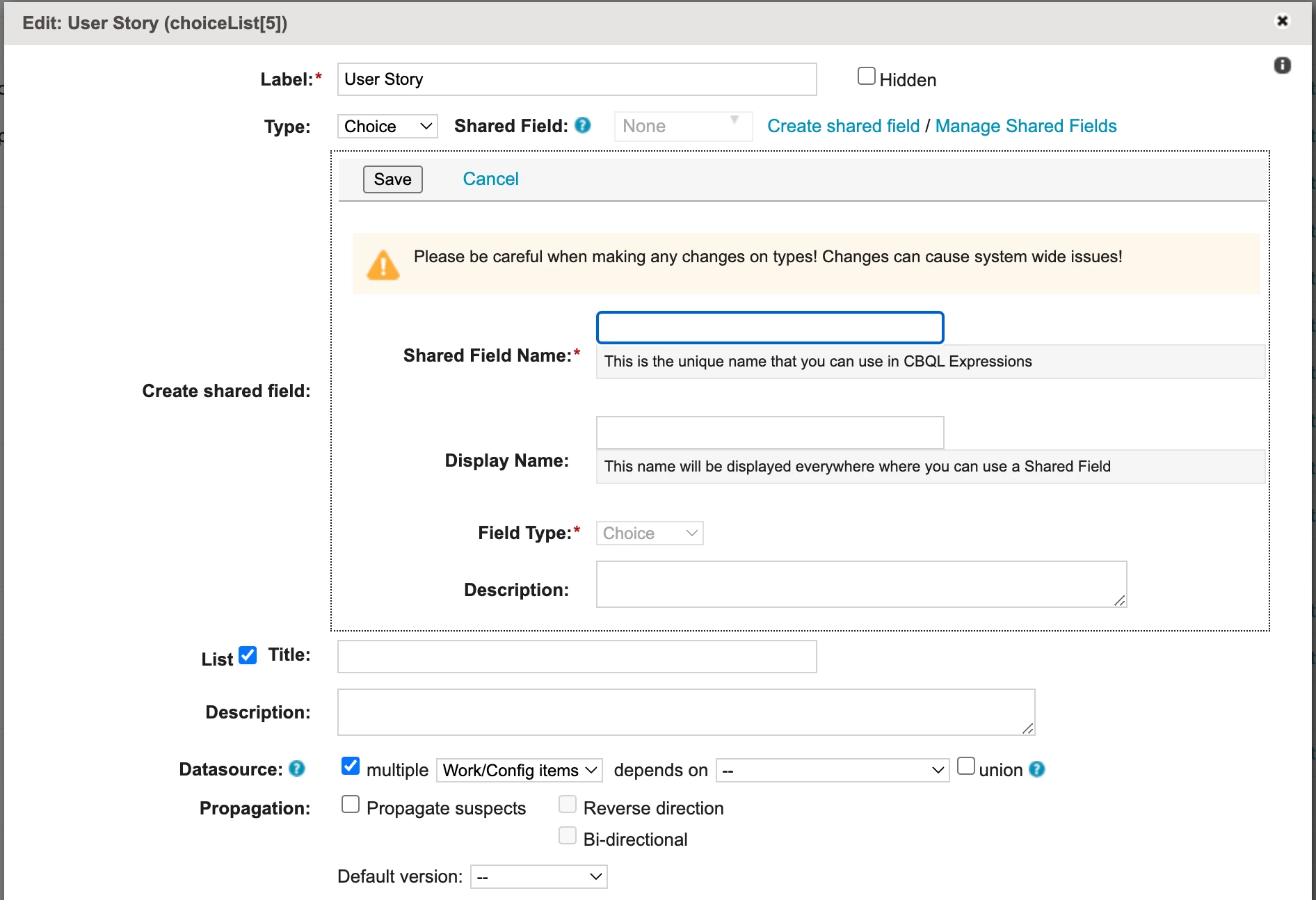

Thank you so much for your quick response! I created a Shared field for User Story from my already existing field. It did not allow entering a Field Type and automatically chose "Choice". I added the Shared field to a different task tracker 'Code & Doc Review' and set 2 tasks to the same User Story value, but grouping by the Shared field does not display the User Story like in my original image. Do you have any other suggestions?

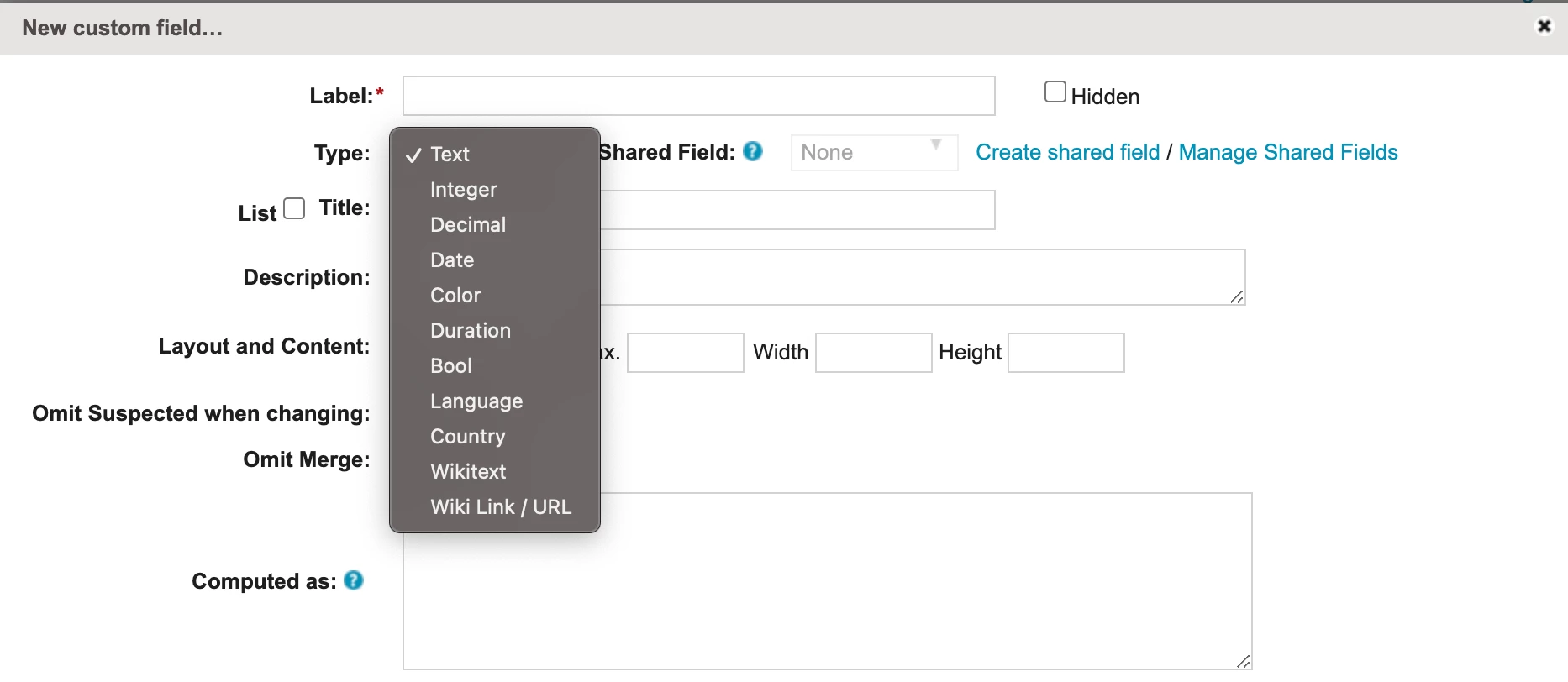

I also tried creating a new Shared field using "Reference -> Tracker Item" as a data type. But I am unable to select a custom field type of "Reference" from the dropdown so the new Shared field is not populated (See How to select Shared Reference field).

I tested it with "Reference -> Tracker Item" and it worked for me. What I did different was that i used "Manage Shared Fields" instead of "Create Shared Field". This action opens a new window with all shared fields and there is an option to create new shared field. If you do it in that way then "Field Type" is not pre-filled and you can choose your Reference -> Tracker Item.
Once you have it you need to do the following steps, in this order:
1. create new choice field/open existing
2. make sure that datasource = "Work/Config Items" (without it you would be able to select in Shared Fields only those for "choice").
3. When the datasource would be "Work/Config Items" in Shared FIeld pick list you should see only those for "Reference -> Tracker Item".
