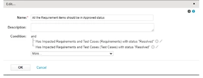

Guard condition related issue, while moving from one state transition to another
  • September 21, 2023
  • 670 views
I have applied below Guard condition between the state transition "Accepted" to "Implement" for the reference field "Impacted Requirements and Test Cases".
1. The above guard condition is working in such a way that, transition is happening at least one item is in Approved status.
2. Requirement is, transition should happen only if all the linked items to the field "Impacted Requirements and Test Cases" in Approved status.
Does it possible to apply guard condition as per the Requirement? If so please guide us to apply guard condition as per the requirement.
September 21, 2023
Just reverse the logic: "Has no Requirements and Test Cases (Requirements) with status "Unresolved"
