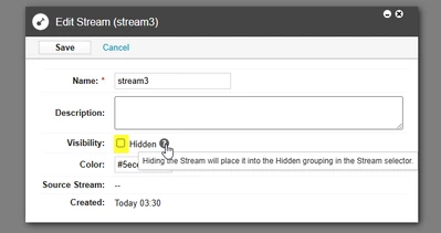

How do you delete a Stream in codeBeamer?
I created a stream to test the feature. I can not see in the UI how to delete it. And there is no end-point in the REST API to delete a stream.

Note that we are agree that it is important to be able to delete streams ... not just hide them.
There just wasn't time in the 3.1 development cycle to get this implemented, so "hiding" is the workaround to be used until the delete-stream operation is available.

Unfortunately, currently Stream cannot be deleted (by design).
The only thing, you can do is, to hide it.

Jun 22, 2026 12:18 PM UTC
