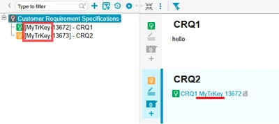

Have you tried tracker.key? It seems to work for me.
 "myitem" : {
 "link" : {
 "text" : "${summary} ${tracker.key} ${id}"
 "popup" : {
 "text" : "${interwikiLink} Status: ${status}; Description: ${description}"

Hi @PolarBear,
that is exactly what I was looking for. Thank you.
