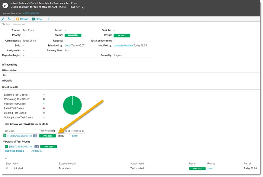

Hi, @YW_10142311 , I assume this is related to a Test Run. If so, to which part do you refer, is it the below?
May 14, 2024 6:13 AM UTC
@YW_10142311, you gave "Kudos" to my previous question, so I assume you are indeed interested in getting that field with REST API or computation.
To get the Test Result of a Test Case's Test Run, you can chain 2 REST API calls:
1) Assuming the Main Test Run has ID 2094 as in my screenshot above, get its child items with GET /v3/items/2094/children:

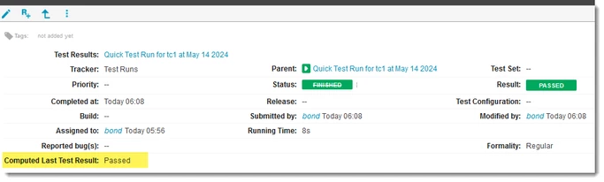

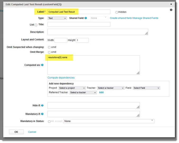

With computation, you can e.g. add a custom Text field with the resolutions[0].name formula:
Does this help you?

@alfonso_c Thank you so much.
This is very helpful. We want show the Last Run Result in Test Case Tracker , Due to your inspiration we add a custom Text field with
   first(1,downstreamReferences(this).trackerTypes("testrun").{item| item.resolutions[0].name})  formula and it works!
