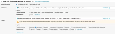

Hi community,
I have the following configuration (codeBeamer 2.2.1.0.4).
This gives the following result.
Now, I only would like to see the latest run of this test case.
How can this be done in the configuration?
Or is there any other possibility to manage this?
Thanks in advance.
Best regards.
Pascal

Oct 10, 2025 3:05 PM UTC
Hi  - i am not from ptc - so not an "official" solution. We do it with 2 calculated fields on the testcase,
the first gets the ID of the latest testrun (basically just the one with the highest ID) and the 2nd field fetches the result of the item with that ID.
Formulas:
to get the ID of the latest run: "Last Formal Run ID" = max ( distinct (downstreamReferences.trackerTypes('TestRun').{item | ((item.resolutions[0].id <= 4 ) && ( item.formality.name == 'Formal' ) ) ? item.id : null } ) )
to get the result of  that testrun: lastFormalRunID > 0 ? Item(lastFormalRunID).resolutions[0].name : 'No Run'''
This way you can display the last formal run in a traceability table.
if you need not just the result of the formal run, you can remove the condition in the formula of Last Formal Run ID field. if there is no run, the formula returns 0, that is why we have the condition in the 2nd formula.
