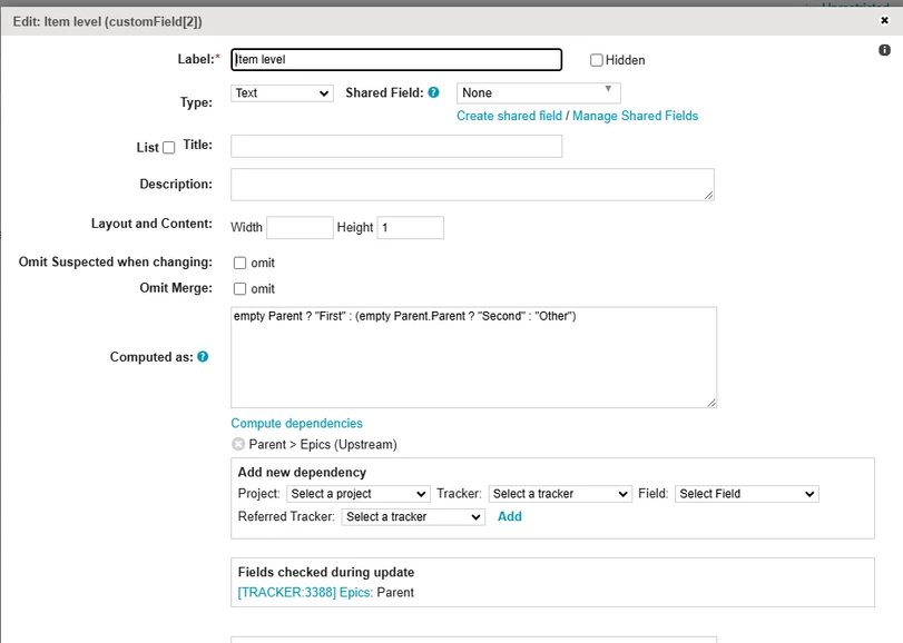

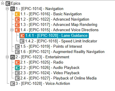

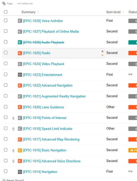

Feb 28, 2025 12:24 PM UTC
I've set a computed field with this formula: empty Parent ? "First" : (empty Parent.Parent ? "Second" : "Other")
This is the result:

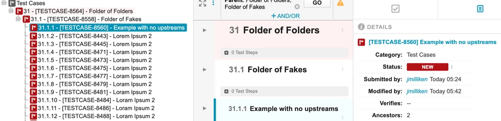

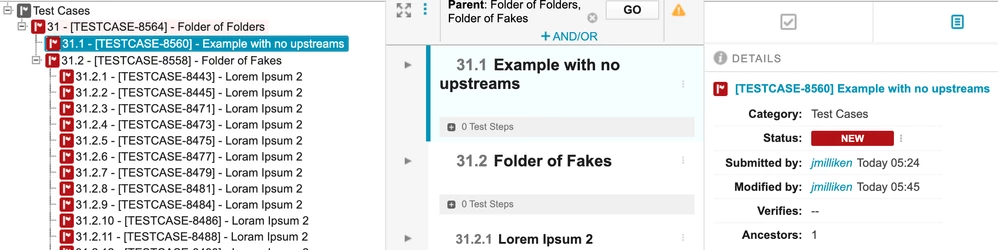

Hey, I was able to achieve what you were looking within a single tracker by creating a computed field with this expression:
empty Parent ? 0 : Parent.customField[1] + 1
where customField[1] is the property of my Ancestors custom field.
As you can see above, I've created two items as parents, and this example item with a parent that has a parent has a value of 2 in the Ancestors field.
 And now that it's parent has no more parents, the Ancestors field has a value of 1.

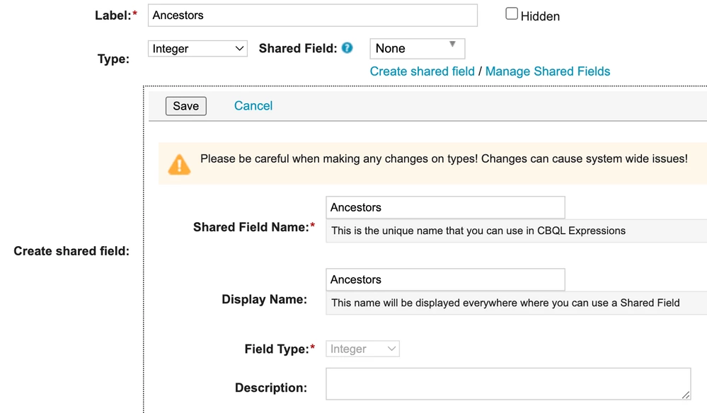

If you wanted this to work across trackers, or to be a bit cleaner of an expression, you could create an Shared Field for "Ancestors" and associate these individual tracker fields with this shared field like so:
Allowing us to use this new expression easily:

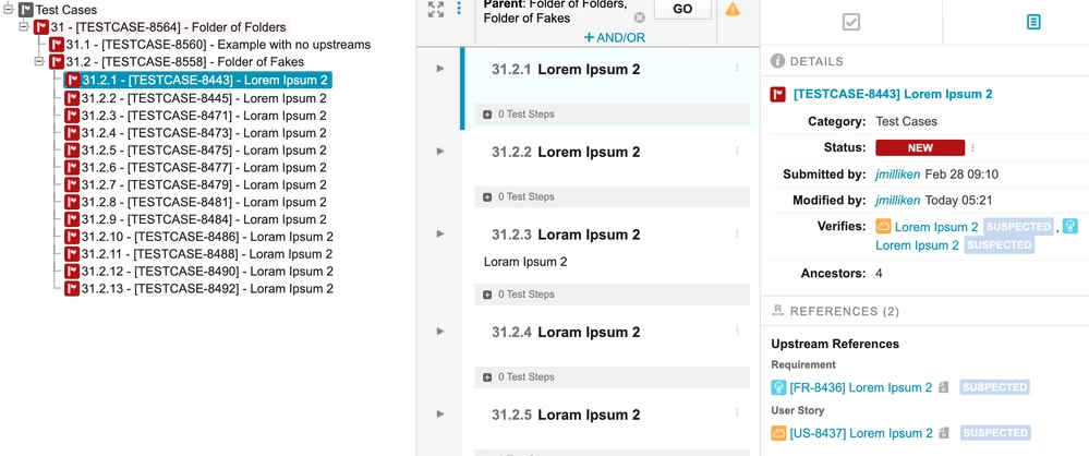

max(List(max(subjects.{subject | subject.Ancestors + 1}), empty Parent ? 0 : Parent.Ancestors + 1))
4-ancestors-across-trackers.pngFor this particular "Loram Ipsum 2" item, it has 4 ancestors - that being a User Story, with an upstream Feature, with an upstream System Requirements, with an upstream Customer Requirement.
This works within a single tracker as before by traversing the Parent, but also works across trackers by finding the max of all the Ancestors fields in the subjects tracker.
