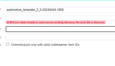

Hello
I am  able to Integrate Git with Codebeamer am able to clone all git files locally but from codebeamer I get
I am using CodeBeamer 22-10 LTS and github.com is GIT Repository
My codbeamer url is http and my git is https .Is this a reason for that .I selected  Use an existing repository option

Hello @shrinivas,
If you have access to codebeamer.com Wiki pages, please follow the GitHub Webhook settings and try function again.
Link to the GitHub Webhook Wiki: https://codebeamer.com/cb/wiki/3825088
When you have still experience issues with Git settings, you can raise an incident case in our eSupport Portal: https://www.ptc.com/en/support/
Thank You.
