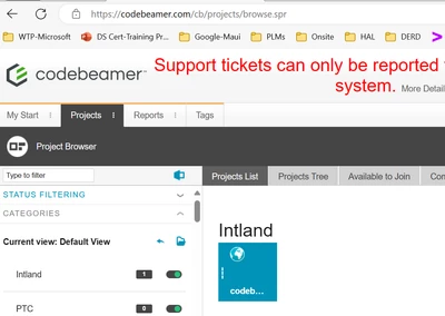

In Codebeamer Web UI , I am not able to find + icon for project creation In Project Explorer
In Codebeamer Web UI , I am not able to find + icon for project creation In Project Explorer,
Does i need to have any specific role for this.  Advance thanks for your help.

Hi @RD_10592613 , the permission to create projects on https://codebeamer.com is probably not granted to all users. If you want to experiment / create a project usable by others, you may use https://trial.codebeamer.com/
Jul 19, 2024 2:34 PM UTC
I usually check 3 things on tracker configuration in this case:
- item creation perm is granted for user's role on Permissions page
- role has edit perm on all fields which is mandatory on Submit status (Fields page)
- role has the perm to execute the Submit action (State transitions page)
If all of these are granted, add item will be possible.
