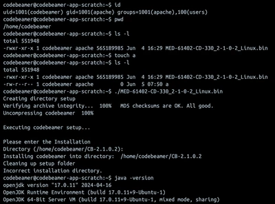

I am attempting to install CB 2.1.0.2 on ubuntu  and have done (hopefully) all of the pre-requisite steps.  When I login as the "codebeamer" user and run the installer, I get the following error:
sh MED-61402-CD-330_2-1-0-2_Linux.bin
Creating directory setup
Verifying archive integrity... 100% MD5 checksums are OK. All good.
Uncompressing codebeamer 100%
Executing codebeamer setup...
Please enter the Installation
Directory (/home/codebeamer/CB-2.1.0.2):
Installing codebeamer into directory: /home/codebeamer/CB-2.1.0.2
Cleaning up setup folder
Incorrect installation directory.
Any guidance on this?

Okay so the shell debugging helped.  It turns out the `cpio` command was not installed.

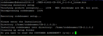

June 5, 2024
I checked and it seems ok to me:
Can you please let me know the permissions and ownership of the installer?
June 5, 2024
Also please let me know the permissions of codebeamer folder.

June 5, 2024
Here are the permissions and another execution of the installer:
Are there any other prerequisites that might be missing? Unfortunately the installation instructions are scattered and have different information (e.g. one place says to install Java 8 and another says Java 17). But I couldn't find anything else that is required.
