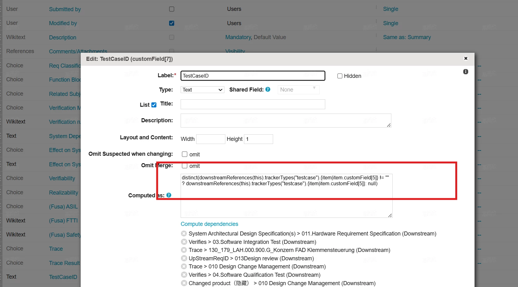

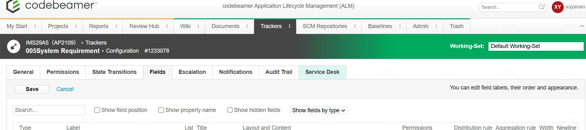

I am using Codebeamer Release 2.2.1.3 . On Tracker, there is an issue: test cases are auto-traced to system requirements, but we don’t want automatic tracing when the verification method is design review.Automatic tracing of test cases to system requirements shall be omitted, provided that the verification method is specified on the system requirement and the method is design review. The compute code is as below:

distinct(downstreamReferences(this).trackerTypes("testcase").{item|item.customField[5]} != "" ? downstreamReferences(this).trackerTypes("testcase").{item|item.customField[5]}: null)////////compute code///I think you should add precondition that the verification of the requirement is design review can not be auto traced by test case

Thanks for your reply.But it is not a reporting issue. The auto-trace rule is set by codebeamer system. And the compute rule lose a condition.There is a one situation that  i do not want the system  requirement auto-traced by test case because the software requirement is traced by artificial retrospective tracing.(software requirement is downstream of system  requirement).The situation is when the verification method of system  requirement is design review

Try wrapping the existing logic in a conditional that returns null when the verification method is Design Review:
yourCustomFieldPropertyNameForVerificationMethod is NOT "Design Review" ? distinct(downstreamReferences(this).trackerTypes("testcase").{item|item.customField[5]} != ""
? downstreamReferences(this).trackerTypes("testcase").{item|item.customField[5]} : null)
: null
An important note, choice fields in Codebeamer behave as collections even when single-select, so you usually can't compare them to a string directly — you compare against the option name, e.g. something like !this.customField[N].name.contains("Design Review") or by the option ID, depending on how that field is set up. That's the one piece worth testing carefully.
Also, after editing the formula, add Verification Method to the field's Compute dependencies so the TestCaseID value recomputes whenever the verification method changes.
