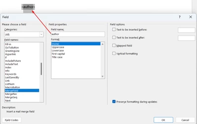

Hello all,
export tracker to word using eg. default system template works fine and data are visible.
But it does not work if Merge Field is edited:
 1) { MERGEFIELD  author \* MERGEFORMAT }  -> author is rewritten manually
or
2) { MERGEFIELD  author \* MERGEFORMAT }  to { MERGEFIELD  baseline \* MERGEFORMAT }
or manually inserted : Insert tab > Text > Quick parts > Field > Merge field
If working Merged Field is copy/past then it works.
Is there any special formatting or syntax needed for working with Merged Fields in Word document?
thank you

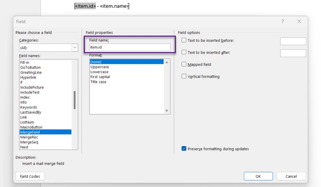

Mar 11, 2025 3:07 PM UTC
Hello @MM_10991077 ,
I usually manually insert them with the Quick parts > Field function, but without the { MERGEFIELD ... MERGEFORMAT } commands:
Mar 12, 2025 7:10 AM UTC
Hello EvaBertalan,
I did the same but for some reason it is not working.
the { MERGEFIELD ... MERGEFORMAT } is shown when you press ALT + F9
Below you can find picture with original working merge field and manually inserted via above step.
They look the same but it is not working.
thank you
