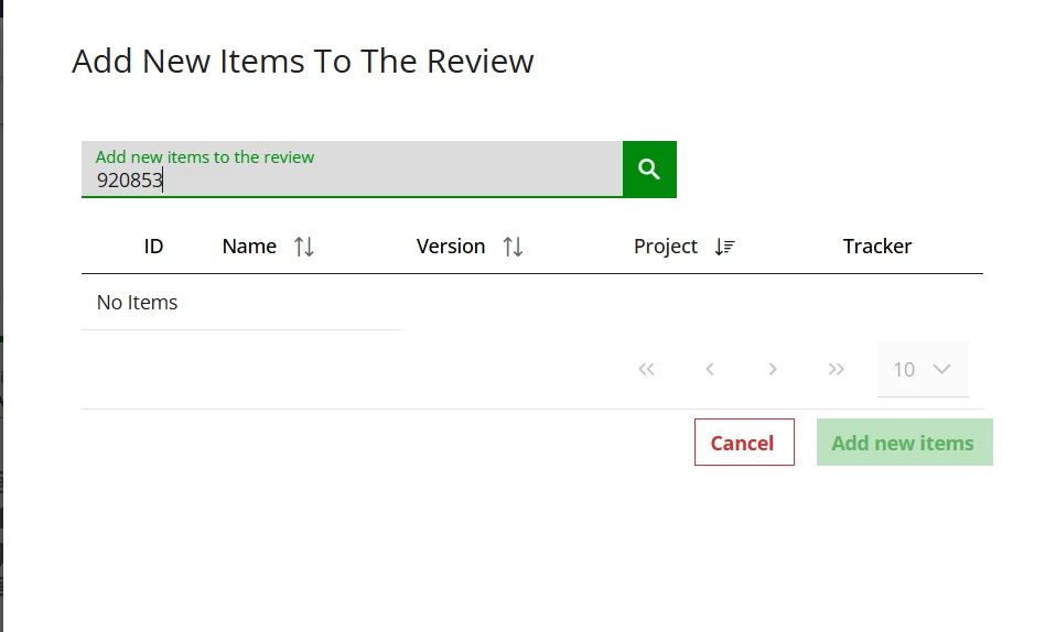

Not able to search item using item id in 2.2.1.2 and 3.1 version , which is working in older versions.
While adding any new item to an existing review .
1. Not able to search item using item id , which is working in older version.
CBIAnswer
May 20, 2026 11:28 AM UTC
Based on the information I received the IDs are not working within the NEW review hub only text, but everywhere else.
I already created an idea for it, where you can vote on.
https://community.ptc.com/t5/Codebeamer-Ideas/Review-Hub-Adding-an-item-via-search-by-unique-id-is-not-working/idi-p/1016149

attachement
CBI10-MarbleAnswer

Hi ​@RP_10913264 could you verify that the review is configured to include the project and tracker of the item you are searching for?
