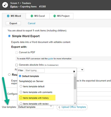

It is possible to export a work item with a specific Word template.
Open the Exporting Items pane, and select "Items template with history" template on the bottom of the page.

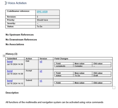

Using this template during the export you'll have a History table about the changes on the item:
