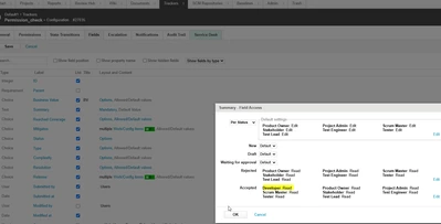

For permissions based on status you can only use what I already suggested.
If you set all field permissions to Per Status and give no permission to Developer team, but only in Done status (Read permission), members of Developer role will see the content of the item only in Done status.

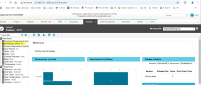

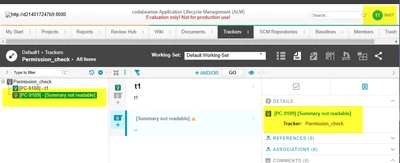

I made the following little test:

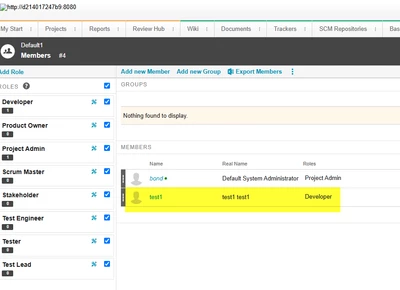

I created a user called test1.
I added it to Developer role:
I created a new tracker called Permission_check.

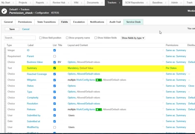

I set the Summary field permission in that way, that Developer role has only Read permission in Accepted status and nothing in other statuses.
I set all other field permissions to Same as Summary.

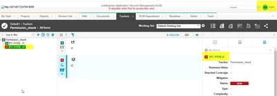

I created 2 items in the tracker and set one of them to Accepted, the other remained in New.

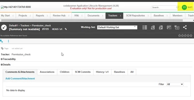

I logged in with test1 user in an incognito window and checked the content of this tracker and saw this:
and saw this, when double clicked on item 9109 in the left tree
I hope it helps!
Dec 12, 2024 7:12 AM UTC
yes, if you go to the Tracker configuration, Fields tab, you can find the Permission column, there you have to select Per Status permission, and then you can define, in which status, what role have what permissions.
