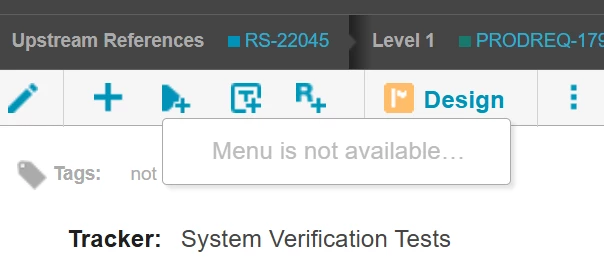

Permissions to run a test case into test run tracker
I’m having issues with the permissions required to run a test case. I tried different configurations but for now only admin can run a test case. When the run is initiated, then a tester can finish the test run. Regular uses don’t have the menu to run a test case into the test run tracker.
Is there something specific in the permissions that need to be enabled?

@Brian Kampling sorry for the delay but I resolved this issue. The issue was in the permissions of the states but not in the permissions table. This had to be changed to the appropriate role when a new state is to be:

Could you provide a screenshot of what you are seeing?

Here is screenshot when hitting the run button:

​@VT_10905160 I believe that you will need to restrict who can create new test runs. Since running a test case triggers the creation of a test run, locking that down should control who can execute test cases.
