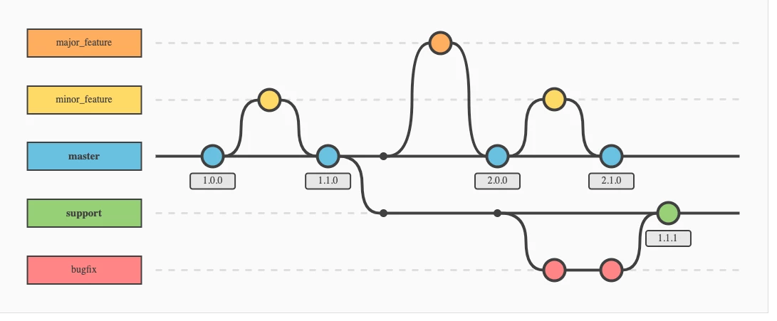

Okay, I think I see what is happening.
If you are familiar with Git, streams work the same way.
Once you create a sub-stream, it is completely unaware and has no access to what is in the parent stream or sub-sub streams. If it was, then data could be modified across streams and it would undermine the purpose of streams. If you have a work item that is not in a stream, you will need to merge it into your stream, before trying to link to it.
Here is a visual example of how Git and Streams work:
Brian Kampling | Source Allies Inc. | Systems Engineering Consultant
