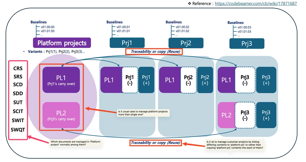

Our company, which is supplying SW packages in automotive as tier 2, is planning to get ASPICE assessment with Codebeamer projects. We roughly estabilished our concepts as attached based on Codebeamer wiki
Before departing this, we have questions which requires the expert's guidance and confirmation.
  1. Is it ok to manage customer projects by linking differing contents to 'Platform project' rather than copying 'Platform project' contents into each of customer projects?
  2. Is it usual case to manage platform projects more than single one?
  3. Which documents are normally manged in 'Platform project among lists?
  4. How can we handle baselines efficiently? Does this concept described in below image make sense?
Thank you
Geoffrey Clemm
Sep 13, 2025 10:23 PM UTC
Cross-project linking is now supported fully, in Codebeamer 3.1.  Cross-project baselining is in-plan for Codebeamer 3.2.
