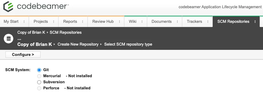

SCM repository integration
  1. Codebeamer SaaS provide a Git/SVN repository as part of our subscription
  1. Or do we need to create and manage our own Git repository and then integrate it with Codebeamer?

Hi ​@MS_14571616
Codebeamer supports Git/SVN repositories at the project level. Click on the SCM Repositories tab within a project and click New Repository. You can also integrate with things like GitHub, Bitbucket, or GitLab.

Hi ​@MS_14571616
