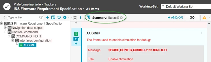

  1. for a key like this "XC%":
    1. The engine find "XCSIMU" (ok), but it doesn't find "XC_DEBUG_SRC" (NOK)

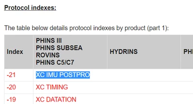

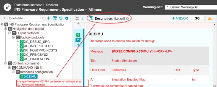

  2. If we do the same thing with "description" field, the result doesn't contain results with de keyword inside a table (same key):
    2. I don't see the requirement wich contains this table with "XC IMU POSTPRO":

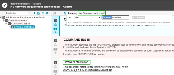

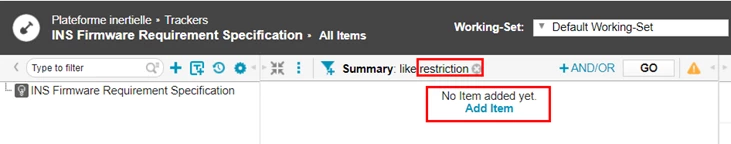

    4. Moreover search for a full title works witk "like" operator, but search for a work in a title doesn't work:
        Doesn't find "Firware restriction"
