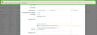

I have tried the syntax you have mentioned from the documentation. This does not allow me to save the changes to the field. I get an error:
Compiling "choiceList[4]_$option[1]" to compute "Validated Cycle/Vendor (AMISC1-6)" failed: "Cannot convert of type class com.intland.codebeamer.persistence.dto.ReadOnlyChoiceOptionDto to interface java.util.List" Please save the tracker configuration before you use newly added fields in expressions.

Dear Chris,
Sorry my bad, forgot one crucial thing:
  • As every choiceField is also a collection (even if its single-choice), you need to put a List() around your computed option, so in your example:
  • List(choiceList[4]_$option[1])
Let me know if that does the trick 🙂
Cheers,
Nico
