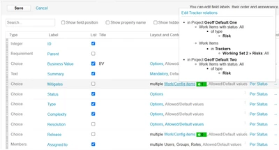

You can create cross-project references to the items you want to share, and when you change the shared item, you will see those changes whenever you navigate those references (either in the GUI or in Reports).

Geoffrey Clemm
June 19, 2025
When you configure a reference field, you identify what items that field can refer to.   In this configuration, you can select trackers in different projects that this field is allowed to refer to.
