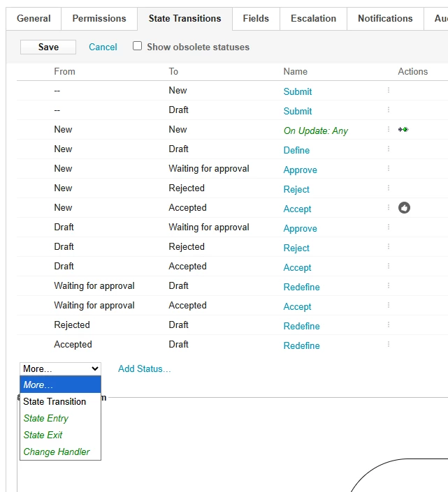

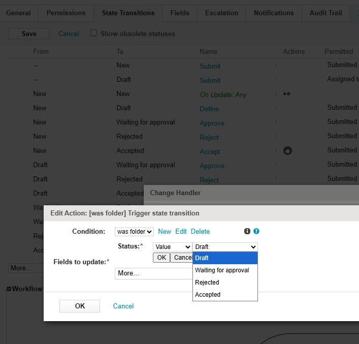

The closest workaround I can find involves using a Change Handler.
The limiting factor here is that I couldn’t select the ‘New’ state for the transition target, but I can get it to transition to draft once I created that state transition.
