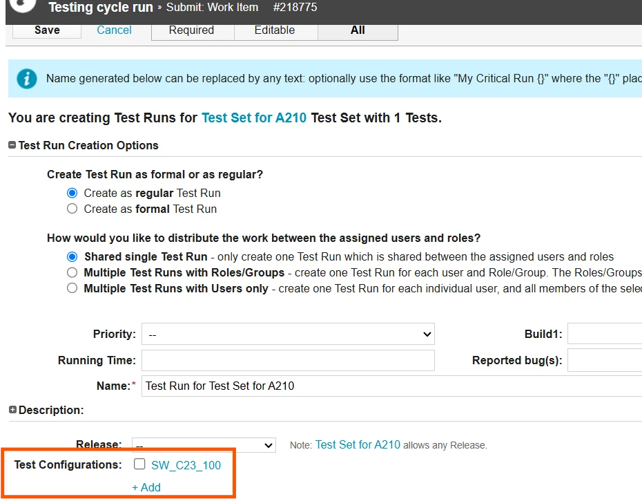

We would like to understand if the below requirement is possible in Codebeamer.

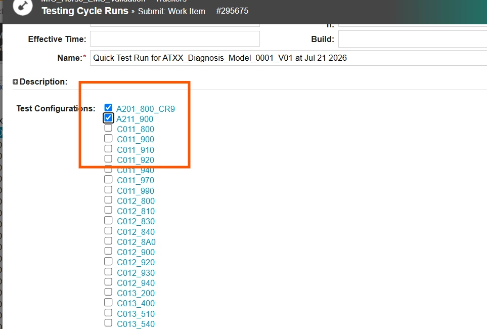

We are creating the Test Run from the test cases, In bottom we have to select an Test Configurations.
Currently it is possible to select the multiple Test configurations while creating the test run, Is there any possibility to select just one Test Configuration out of available options ?
Also, Suppose I have 100 of test configurations So it is very difficult for me to view and select the required test configuration, Instead of it If we have the drop down field of selecting the Test Configurations that would have been a better choice.
Is there any possibility to achieve this also ?

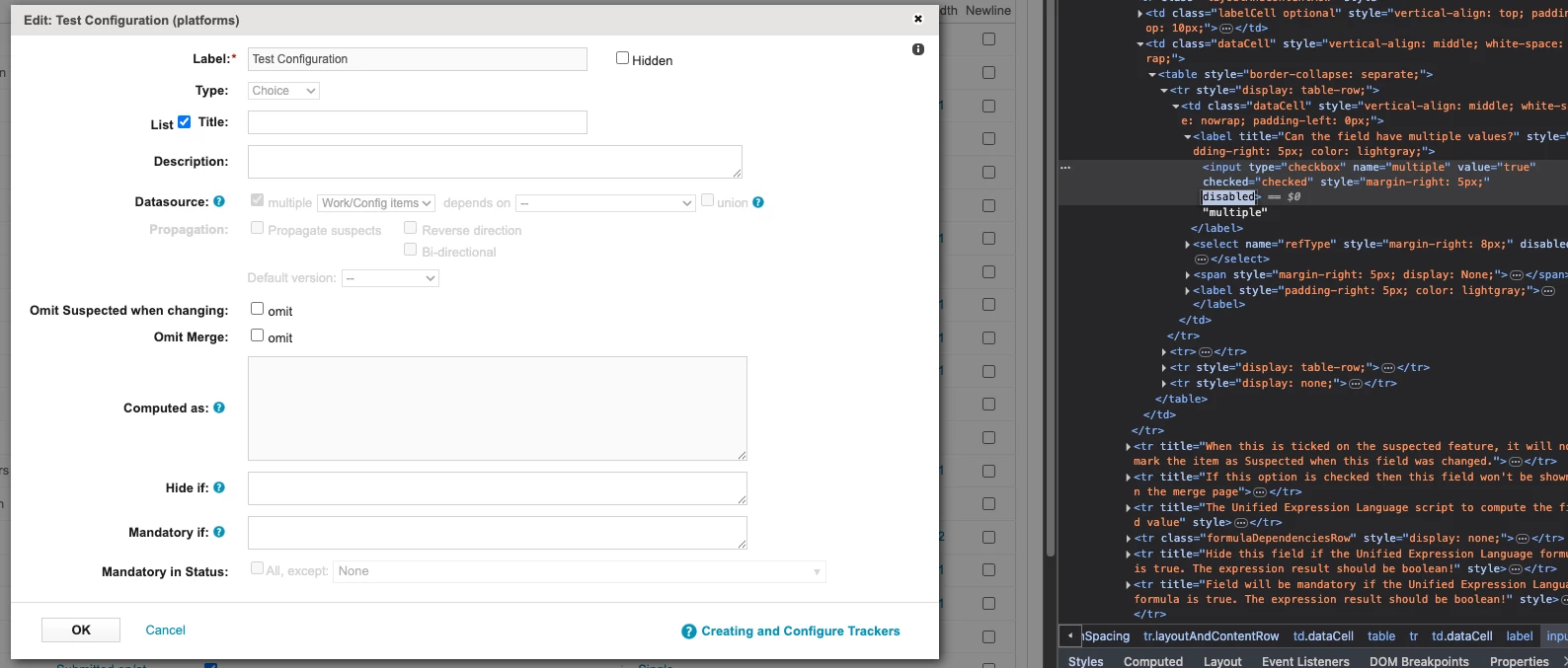

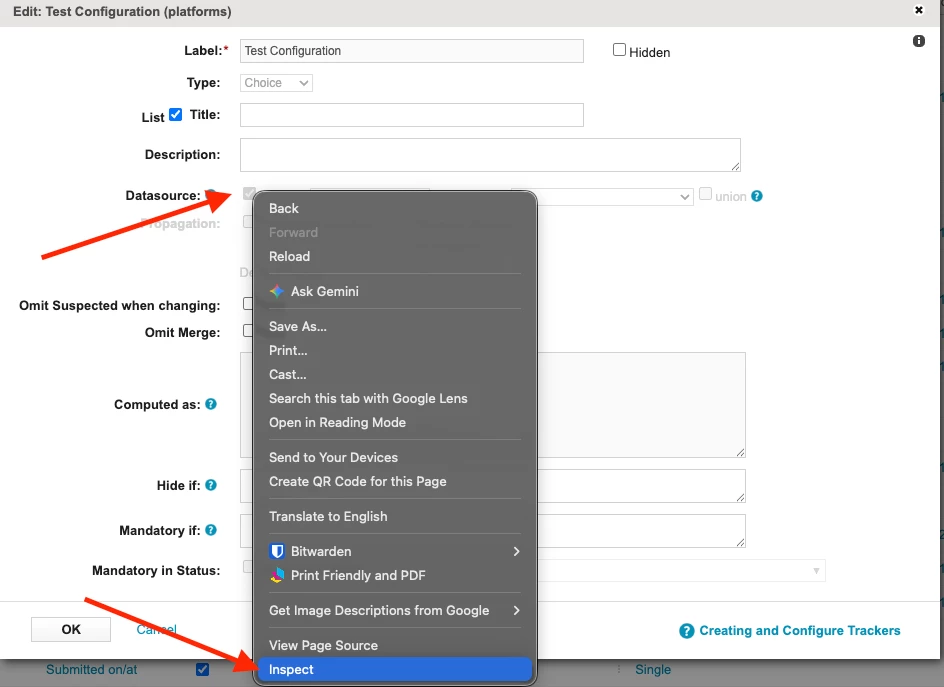

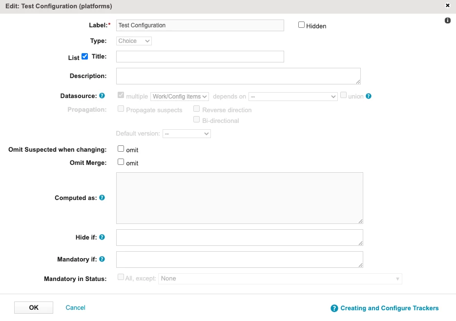

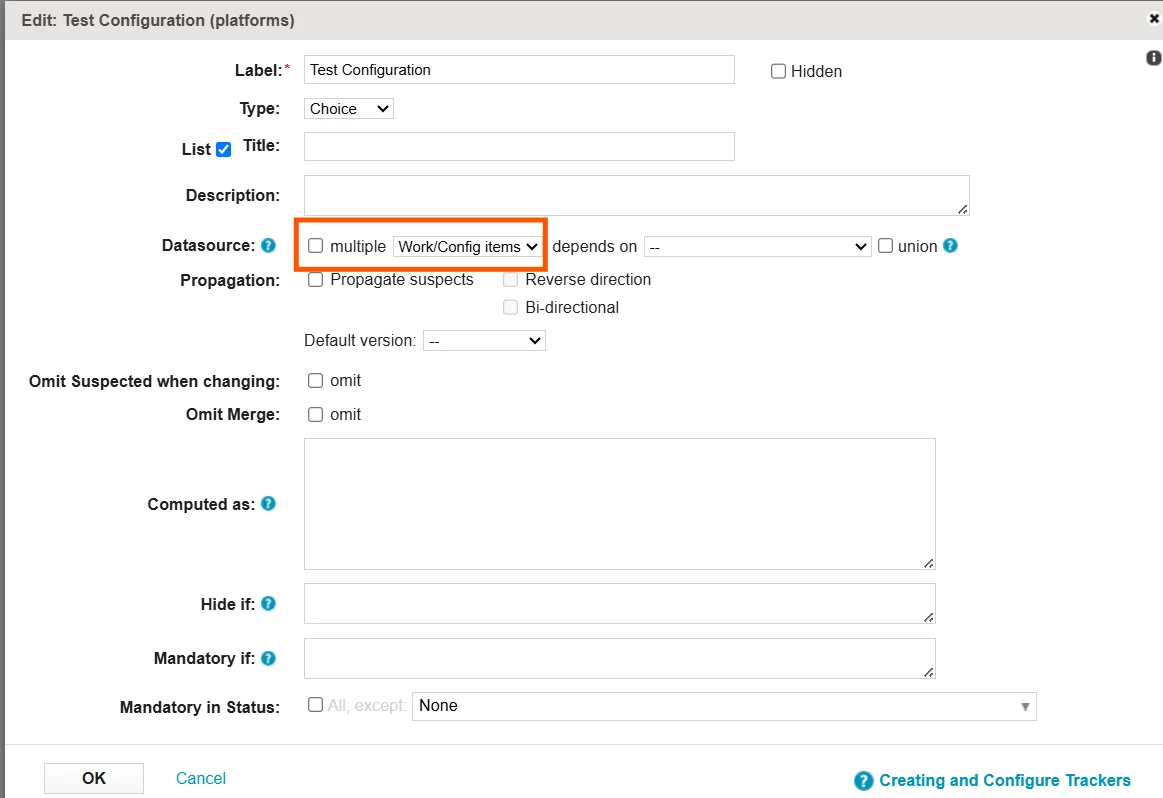

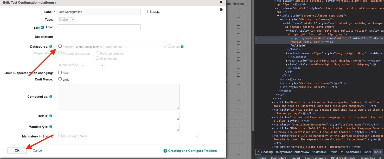

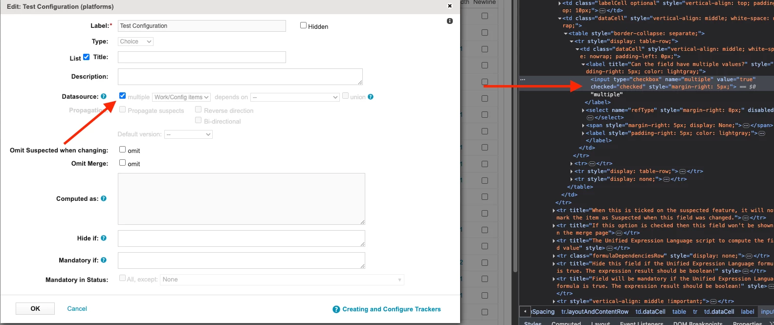

​@SY_10545985 The default configuration is set to just one and has the checkbox for multiple disabled. I’m guessing your template some how has that reversed. If the multiple checkbox is disabled you can get around that with the developer tools.
Right click on the disabled checkbox and select “Inspect”
Double click on the disabled attribute and delete it and press enter, DO NOT REFRESH the page or this will revert.
This will allow the checkbox to be checked/unchecked.
After checking / unchecking click OK and then click Save on the main fields configuration page.

Jul 21, 2026 8:20 AM UTC
Hi ​@BKampling_SAI
Thanks for providing information !
I have tried this solution provided however even after unchecking that check box we are able to select the multiple test configuration while creating an test run.

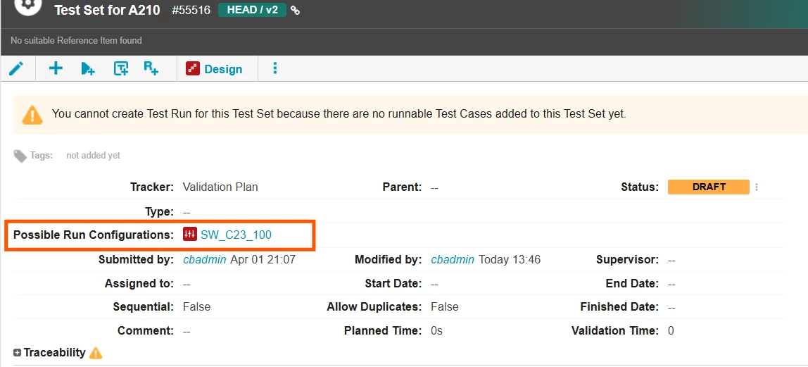

We have identified another possible solution to restrict the test configuration to single select but that was just if we are creating the test run from test sets.
  1. create test set of test cases
  2. while creating test set select → possible test configurations
  3. save test set
  4. create Test Run from that test set, in bottom observe, the test configurations are selected earlier while creating test set are only visible to select.
    But this approach will only work if we create test run through test set.
