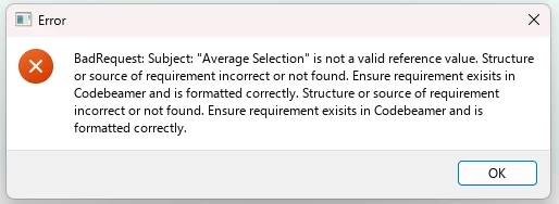

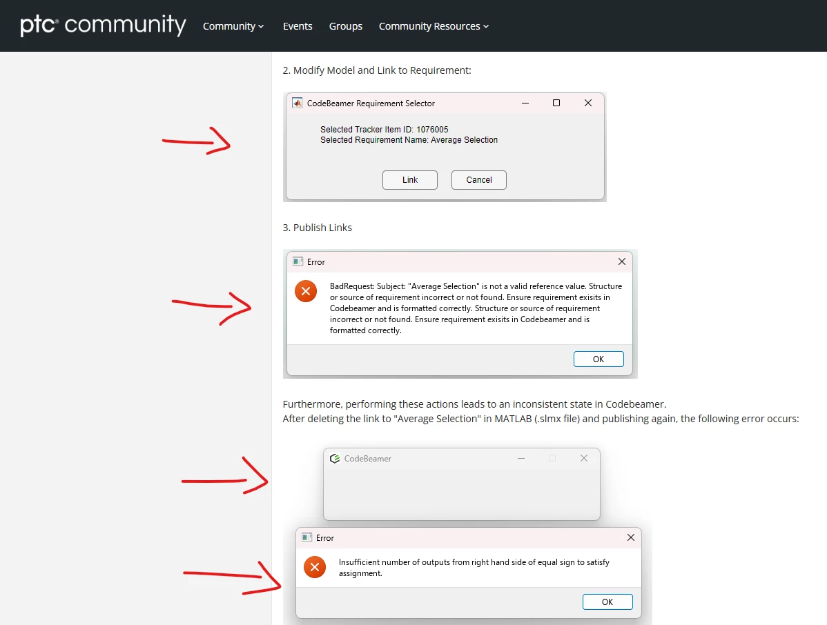

Requirement is created:
MMC does not seem to support creating links to Requirements on a Stream different to the "Initial Stream".
1. Create Requirement on Stream:
2. Modify Model and Link to Requirement:
3. Publish Links
Furthermore, performing these actions leads to an inconsistent state in Codebeamer.
After deleting the link to "Average Selection" in MATLAB (.slmx file) and publishing again, the following error occurs:

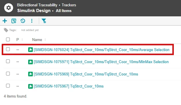

I found out that the plugin already created the proxy item in Codebeamer (but in the "Initial Stream" and not in the "Variant Stream").
After deleting the proxy item, publishing links was successful again.

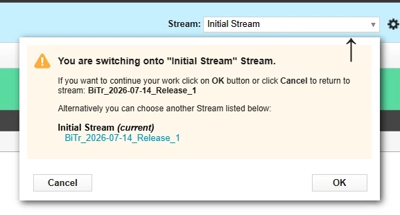

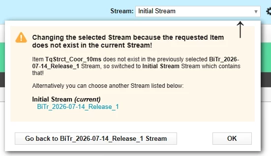

Requirement is deleted:
When clicking the link of a deleted requirement, the requirement is shown as it exists on the "Initial Stream".
If the last active Codebeamer tab is configured to the "Variant Stream", the user is asked if they want to switch to the "Initial Stream".
Upon clicking Cancel, the user is informed that the requirement doesn't exist on the currently selected stream:
This only works if the user already pre-selected the correct stream in Codebeamer.
This is prone to errors and a lot of clicking when navigating a Variant.
The functions "Check Requirement Consistency" / "Publish Link" only pick up deleted Requirements on the "Initial Stream" do not support Streams at all.
Since MMC always queries the "Initial Stream", deleted requirements are not considered.

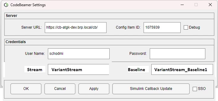

REQUEST:
My request is that MMC supports the context of a stream selected in Codebeamer for Variant Management.
Additionally I would like to be able to select a baseline of a stream that exists in Codebeamer for Release Management.
This could be done f.e. by a selection in Simulink->Tools->Codebeamer->Settings:
I also want to be able to set the context (stream and baseline) programmatically to prevent users from selecting the wrong context. Setting the stream programmatically could also be done by pure::Variants after creating the stream.
Please note that above is just a suggested solution.

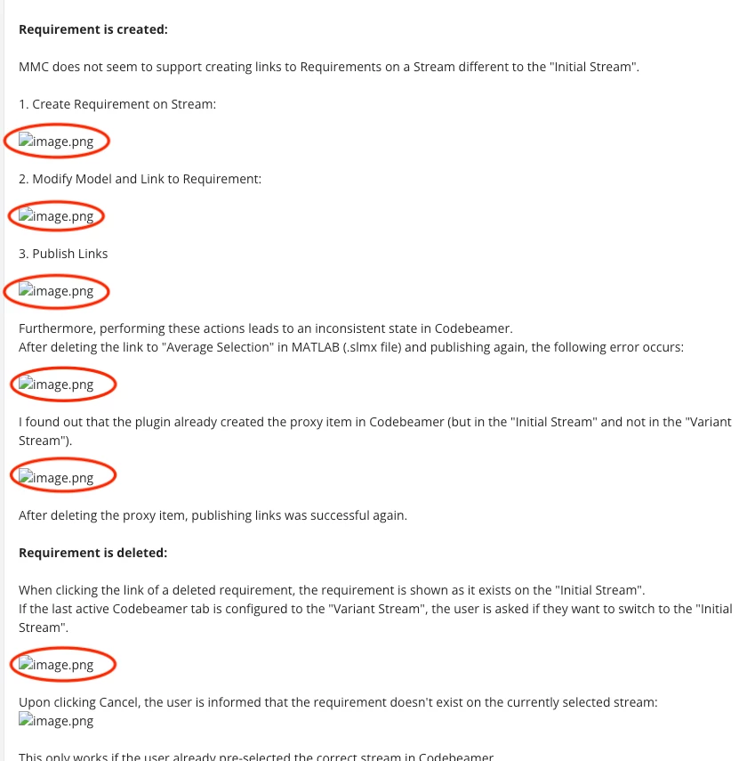

Hello!
First, I wanted to say it looks like the structure of your post is very good!
I just wanted to let you know it is a little difficult to follow what errors you are experiencing and what steps you are following. The images are not displaying correctly. If you can correct those, that should help you get more clear and efficient assistance! Thanks!
7-Bedrock
Aug 4, 2026 6:07 AM UTC
Can you elaborate on what you mean that the images are not displaying correctly, because for me they seem to display just fine:
Glenda_SAI
8-Gravel
Aug 4, 2026 1:47 PM UTC
Absolutely! They’re not displaying for me in the main post, I can see only the words “image.png”. They are displaying correctly in the screenshot you added in the reply here.
