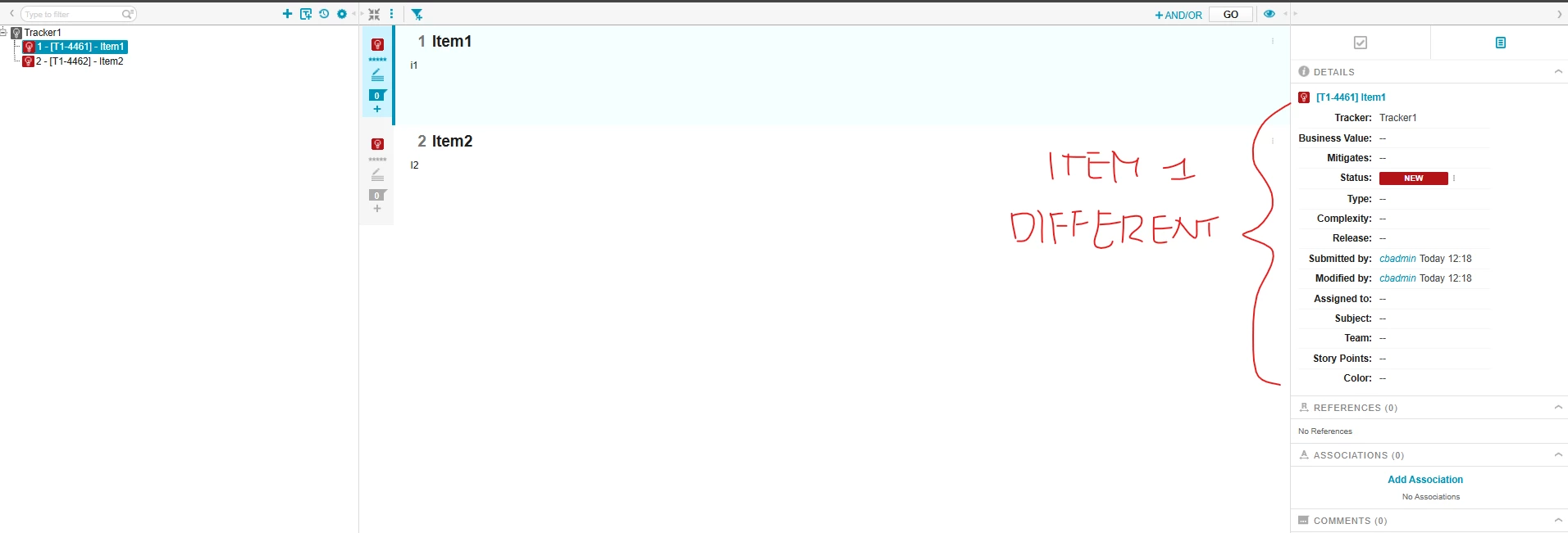

Is it possible to create two items of the same tracker that have different properties?
Example
Tracker Tracker1 that has two Tracker Items: Item1 and Item 2.
Item1 has different properties from item2.
I have attached an image to explain better.
Thank you

the only way I can think about if you prepare your tracker fields Hide if options depending on the value of a given field.
You can read about Hide if here: https://support.ptc.com/help/codebeamer/r2.2/en/index.html#page/codebeamer/user_guide/7214680.html
