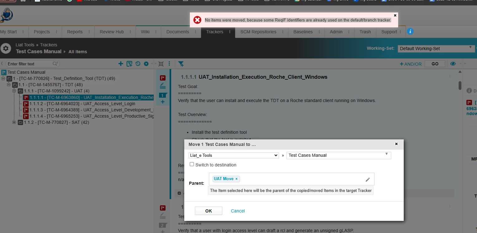

Unable to move the folders from Classic project to e-Signature project encountering an error.
In the Test Case Manual tracker, Unable to move the folders from Classic project to e-Signature project encountering an error.
Error:
"No items were moved, because some ReqIF identifiers are already used on the default/branch tracker."
"java.lang.IllegalArgumentException: Attempt to update non head revision #1 of [10480398] /Comment-1696249646776(head #2)"
According to the PTC team, this is a long-standing known limitation. Unfortunately, there is no workaround, as the system is functioning as designed.
If the target tracker already has same reqif ID, then it will refuse move operation.
From the user’s perspective, moving these items to an empty location should not cause any conflicts. Additionally, the majority of other items from the same location were transferred without any issues. Therefore, it is unclear why these identifier conflicts are occurring, and the user strongly wishes to have this functionality available.

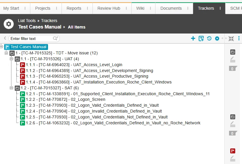

Hi @Venkatalokesh
Could you provide more context about what you are trying to accomplish? We might be able to help you find another way forward. You might be able to use the round-trip Excel to export from your first project, remove the ID column, and then import into the target tracker in the second project.
